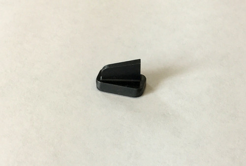

We're very close to having a run of 400 of those sights for the k31 and k11 ready. I'll let you know when and where you can find them. It won't
be from us direct I'm afraid.

Swiss armorers maintained supplies of front sights in various sizes to be installed on individual arms to suit them to the different vision, perception, and preferences of individual firers. Perhaps this simplified sketch will help explain why this was helpful -
Here's Guisan's post on "The 20 official K11/K31 sight blades and their markings..." -
From left to right is lowest to tallest and the middle one is a standard height.
Heights are 5.9, 6.2, 6.5 (standard), 6.8 and 7.1 mm. Changing out a blade by one step moves the POI at 300 meters by 7" (18cm) for a K11 and 6.3" (16cm) for a K31.
The lower row are the normal 1.8mm wide blades, the other rows are the wider ones as used for the senior shooters and for the ZfK55.
