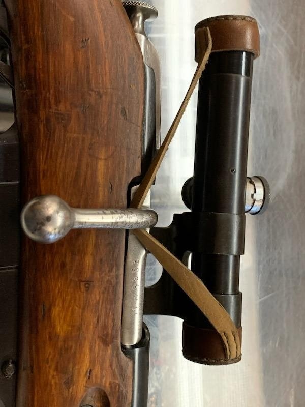

Greetings, I’m being offered this Mosin sniper for under $1k. From a freind of a friend, the picture are well to put it best mostly poor and to me who know very little about Mosins let alone a Sniper Version do not reveal much. I requested a lot more pictures and closeups ect. I will post when I receive them. Is there a chance from theses limited photos it’s even close to being something real? Thanks for all your help.

Yeah these photos are of pretty limited use. The important points will be the top barrel stamp, there should be an additional serial number along the stock line on the barrel, and a better picture of the scope stamping would help a lot.
It looks to be correct mount based off the wide milling lines, but that scope stamp kindof looks like one of the knockoffs but it is hard to tell from the photo.

Well I was going to add to the conversation but you seem to get it, not enough information to say what it actually is, put together, rescoped or true military build. Too cheap to be original probably, good luck

All we need is photo of the barrel shank markings and the scope mount.
However the rifle is promising if the bolt is matching to the rifle, as MH prefix falls under both 1943 and 1944 snipers for Izhevsk being a 4 number digit serial.
As others stated, scope looks to be real and the scope bracket has machining marks typical of izhevsk.
Stock looks really nice too with cartouches still visible.
