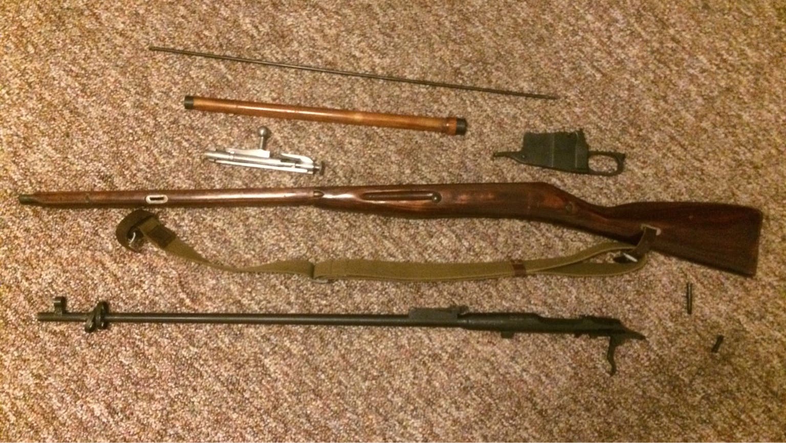

First, I stripped the rifle down.

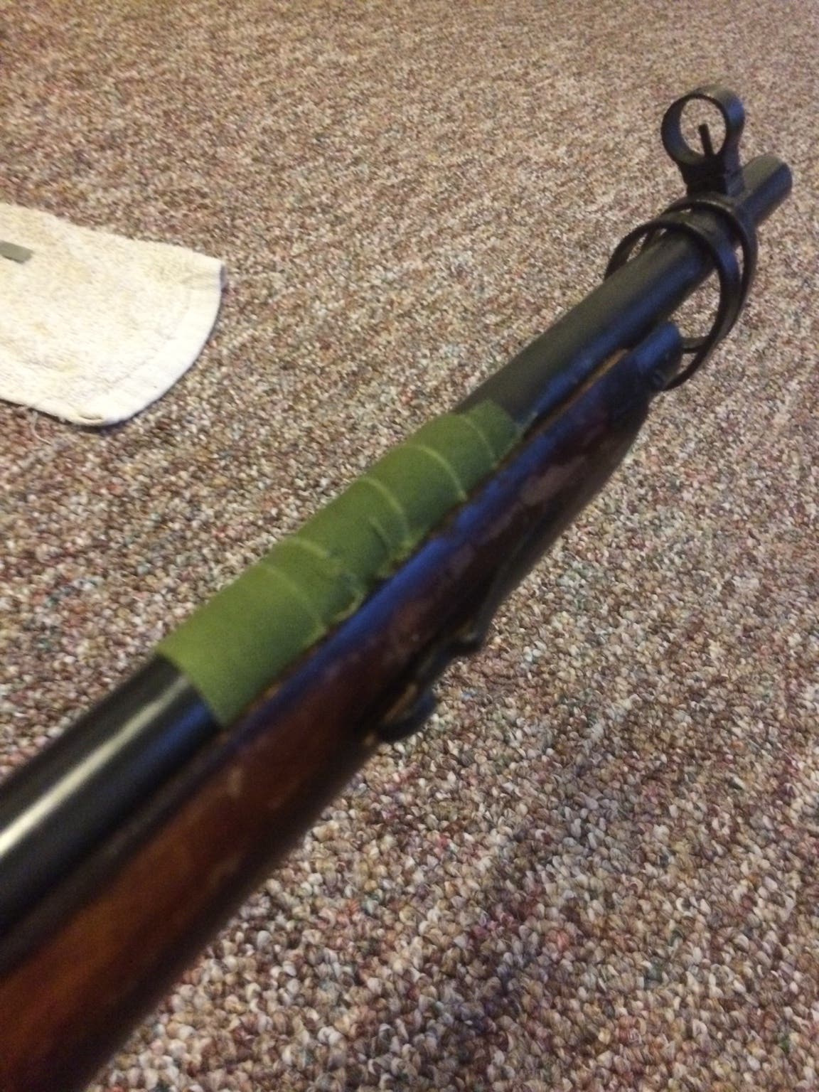

Next I soaked the canvas in oil, and wrapped the barrel at the first barrel band.

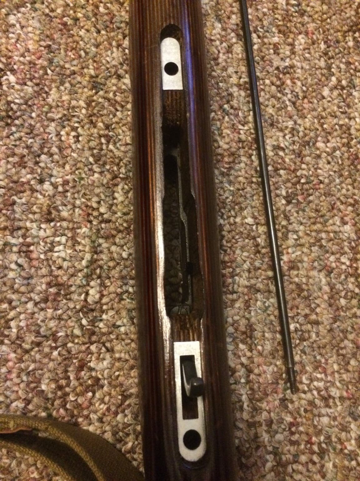

Put the shims in: these are nice. They fit perfectly in my stock and give a "springy" feel to the action screws, so that they feel more secure and less prone to backing out. My action is also rock solid in the stock now (don't remember how it was before).
And it's back together, ready for the first trial at the range. Action shimmed, barrel floating!! Should have the first results by the end of this weekend!

The barrel wrap actually doesn't free-float the barrel but instead dampens harmonic vibration, greatly reducing barrel "whip" on firing.
It also reduces stringing when the barrel heats up in many cases.
My barrel wrapped 43 Tula PU has shot a witnessed 5 shot group to 5/8 inch at 100 yards in local competition slow fire with cooling time between shots using new Novosibirsk "LVE" light ball.

Agreed. The shim(s) placed on the flat behind the recoil crossbolt are what floats the barrel. The magazine shims are used if needed to prevent the action bolts from bottoming out in their holes and/or creating the proper clearance between the top of the magazine and the bottom of the action.
