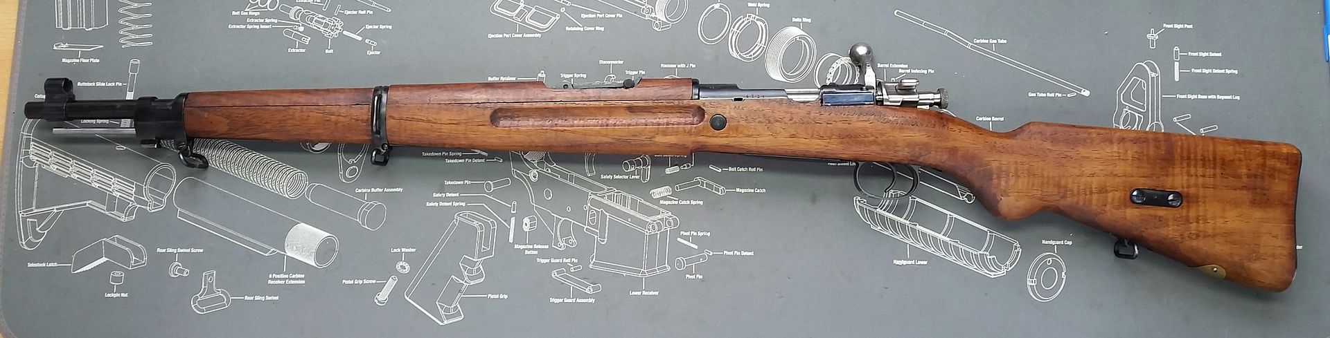

Mexican M1910, 1931 stamp, all matching, serial # 11185
Rifle under wood and under front sight ladder is cosmoline covered so I have no pics there

Fal Grunt -- you have provided some evidence that might answer a question that has been asked and unanswered for many, many years. I am not a Mauser collector and know nothing about the rifle in your photos. Where was it manufactured? Are there any other inspector's marks or other marks on the barrel that would indicate when the barrel was made? Did Mauser pull existing barrels from a warehouse for mating up with the 1931-dated receiver? Here is why I ask ...
This is the inspector's mark seen on your barrel:
And this is the inspector's mark seen on virtually every component part of all but one (maybe two) known surviving Mondragon M1908 rifles, in all versions, that were manufactured by SIG at Neuhausen, Switzerland, in about 1908-10, for the Mexican Government:
Although there are slight variations between them, it is my opinion that these marks are the same, placed by the same inspector.
We do know for a fact that the inspector who placed the marks on the Mondragon rifles was not actually doing his work in Mexico because all Mondragon rifles carry the mark on nearly all metal parts, even though only about 400 rifles were delivered before the Mexican Government cancelled the contract -- all the rest, both assembled rifles and unassembled parts, remained at SIG Neuhausen until purchased by the Germans at the outbreak of WW1. This inspector's mark found all over the Mondragon rifle has always been a mystery. My theory is that it is the personal mark of an inspector working for the Mexican Government at the Neuhausen plant during the Mondragon production run in 1908-10. The mark on your barrel could also be the mark of that same inspector working on behalf of the Mexican Government -- but where and when? 22-odd years later? Or was your barrel actually manufactured much earlier than the date on the receiver? And who was he? A Mexican armorer living in Europe? A European armorer hired by Mexico?
Any light you might shed on this would be greatly appreciated. Perhaps other Mauser collectors have seen this inspection mark? I have scoured the photographic evidence of other guns produced by SIG at Neuhausen and the mark does not appear on even one other gun; the Mondragon M1908 was the only gun made by SIG at Neuhausen for Mexico, as far as I am aware, and it is the only gun that carries that inspector's mark.

These rifles seem to be a mix of supplier components. Possibly Fritz Werner, SIG, and FN, as well as some domestic production of parts, specifically the stocks. It could be arguable that these rifles, and the subsequent components, could be the result of a rebuild campaign later in their use. However I suspect that these rifles are original. This means that these rifles were built from parts supplied by other sources and not domestically produced.
DocAv, the Mexican Mauser rifles (1902/1910/1936) are essentially a 1895 with a 98 bolt, however a transitional early 98 style bolt, that is small gas vents, and the firing pin does not have the interlocking lugs with cam angles. The cocking piece also has the early V at the cocking cam protrusion.
Mexico had previously bought the so called 1895 from DWM, which was actually a 1893 design if I understand correctly (square bolt face). Based on the primary sources I have available, Mexico was looking for weapons in 1901/1902 and with the Chilean contract winding down, I suspect that DWM offered, or it was requested, a rifle that used the same barrels, sights, stocks as their previous rifles.

I don't think SIG Neuhausen ever made barrels for DWM. Fal Grunt is possibly suggesting that the barrel on the pictured Mexican Mauser could have been produced by DWM and, if that is right, then the inspector who placed that unique mark on the barrel was likely working at DWM at the time. This doesn't really solve the mystery of exactly who that person was. Was he a free-lance European (possibly German) armorer/inspector of sorts who was again commissioned by the Mexican Government to inspect barrels destined for the Mexican Mauser M1910? Or was he a Mexican armorer living in Europe and doing inspections whenever and wherever required for his government employer? Does anyone see that particular inspector's mark on any other Mauser that was absolutely, positively manufactured by and at DWM but not for Mexico?
That is not what I meant, let me clarify.
Mexico ordered a batch of rifles in 1902 from DWM. From that point on, they endeavored to domestically produce their own rifles. Mexico did not have the means to do so. Someone produced the parts for them. Mexico has a long history of assembling “parts kits” into rifles.
The Models 1910 and 1936 have always been considered as “Made in Mexico”. I am saying that the parts were not made in Mexico, they were to some degree completed or assembled in Mexico.
I am saying that SIG provided barrels to Mexico. Anymore than that and we don’t have a connection. Could SIG have made the receivers or bolts? Possibly. Fritz Werner could have. FN could have.
In regards to the mark, and the inspector, I have not seen this mark before on any other Mauser rifle. However I do not own a complete original Mexican 1902 produced by DWM. It is more likely that the acceptance mark was applied by a hired inspector, in the limited documentation I have looked at so far, I haven’t found any reference to someone from the commission traveling to Europe for the 1902 contract.
