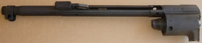

can anyone give me a detailed print on how to put one of these cetme receivers togethere
i need to know how to fold the receiver and where to weld. as well as how to welld the cocking tube to the
receiver.

There are a couple of threads over on Weaponeer.net about bending these flats. One (by nitegunner) uses a 3/4 " steel rod bolted to your workbench and lots of TLC from a long screwdriver. Other methods use a special purpose fixture and a shop press. Either way you'll probably need an internal mandrel to make things true.
I used nitegunner's method and, while it works fine with patience, I needed a mandrel at the end to make the bolt carrier fit properly. I'd definitely use one of the fixtures the next time, if I had a place to store a shop press.
