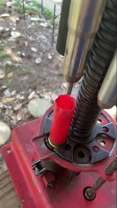

Purchased a used 76 series grabber from a friend. It’s been in storage awhile and so was pretty dirty and has a bit of rust here and there. I went after it with a brush to knock off the heavy stuff then hit it with some Break Free. After that I took the hose and a nylon brush to it. Then I sprayed it down with a 25% solution of Balistol to drive off the water and lubricate the metal to stop the rusting. Once it had dried, I cycled it about 100 times without any hulls before giving it test run with a dozen randomly selected, once fired hulls. Some STS, AA, Gold Medal, Aguilla, and Estate. Of the dozen, I had 4 results like the one pictured below. I think the plunger below the collet re-sizer wasn’t falling far enough, but I’m not sure. Any suggestions?

Collet squishing down rim. You're right, either the plunger didnt go back down far enough or the shell hung up in the collet. No need to oversize cases, just enough they fit in your chamber. Now on to mouth taper-crimp depth. Just try to duplicate factory measurements. Dont crimp too deep.

MEC suggested disassembly and cleaning of the collet sizer and its associated parts. Done. Results in next post

Just when I thought I was making progress:
Now I’ve developed a new issue. Have to “clip” shells into place at about half a stroke:
General consensus is to replace the collet, unfortunately, MEC doesn’t list a 12 gauge collet for the 76 series Grabber. Now on the hunt for a NOS replacement.
