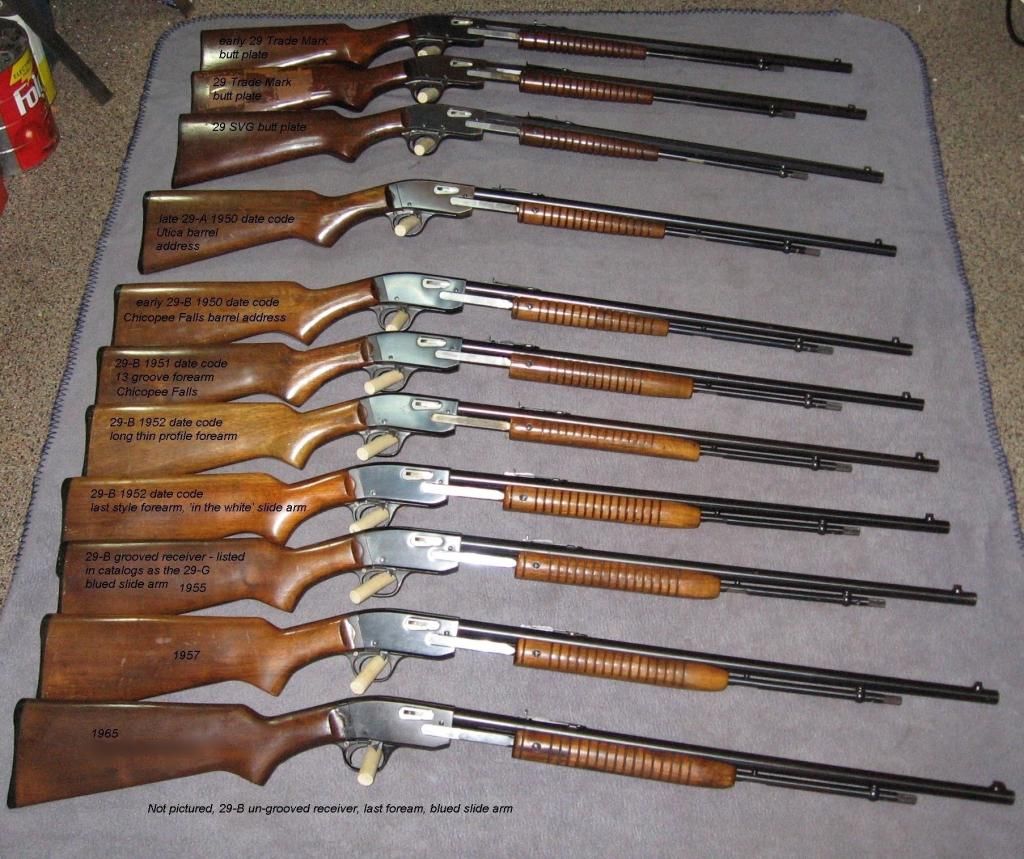

Dennis, 4B would be 1950 and your gun has a forearm that was introduced in 1952, these stamps are sometimes hard to read, I think it is more likely an E or F for 1953 or 1954. They started grooving the receivers for scope mounts later in 1954 which is another indicator of year but your pictures do not show if your gun is grooved or not. Here's a link to a pictures showing changes in 29-B's with the years - http://i200.photobucket.com/albums/a...ps5d43013d.jpg

The 29B was introduced in 1950 but did not get a grooved receiver until sometime in 1954. The catalog did refer to the grooved guns as the Model 29-G but you are correct that this was never stamped on the guns, they were still marked Model 29-B. Changes from the 29-A were the elimination of holes in the tang for a peep sight and the lower/rear receiver got a different finish from the rest of the receiver giving them a two tone look, it also appears to be a cheaper process with a dull matte look to it and seems to wear off much faster than the finish on other parts.
