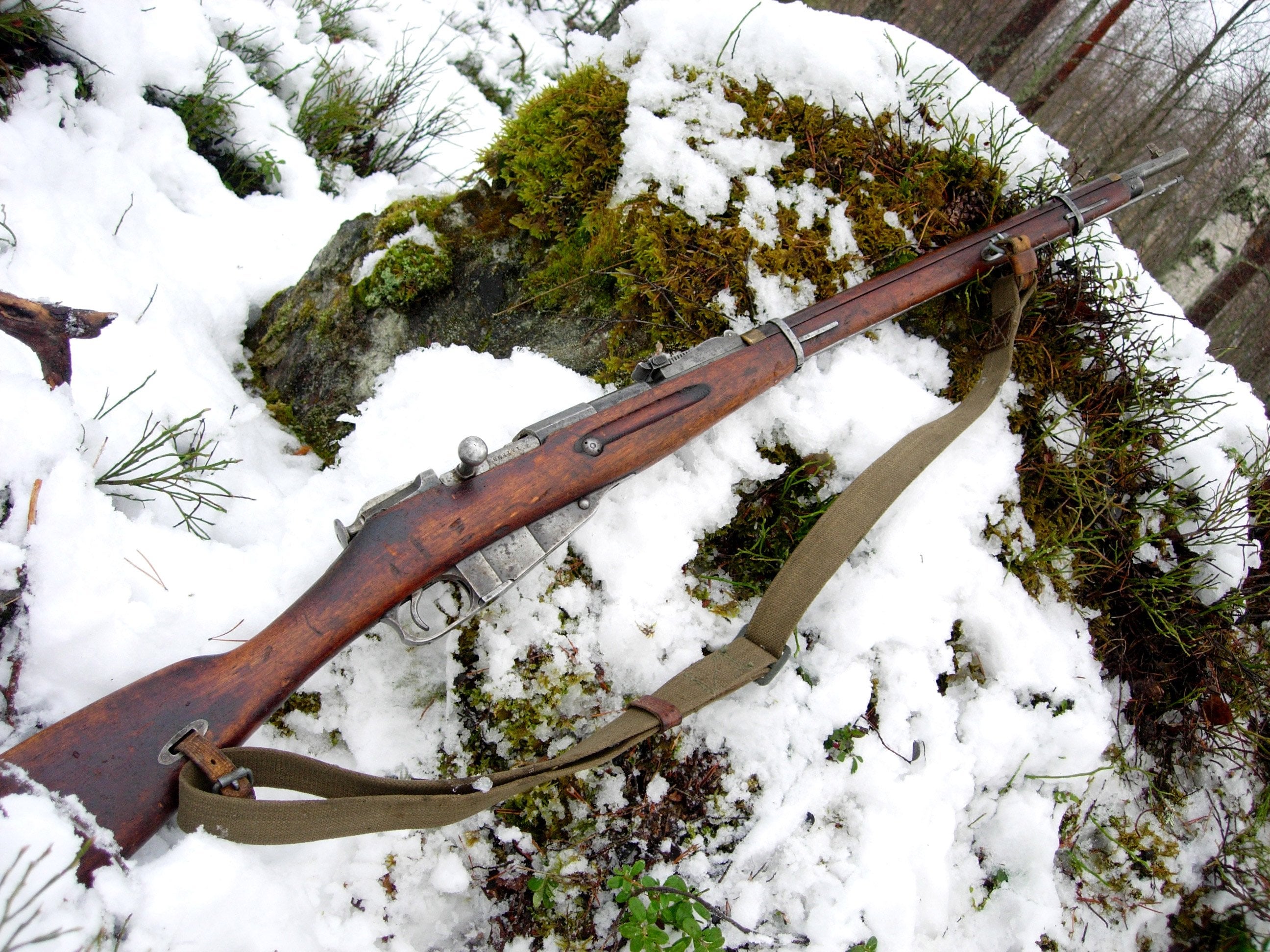

I saw this new-to-me collector's term on the Internet and thought here could be a candidate that fits into this category. The rifle looked pretty honest back in 2008 when I bought it and so far that view hasn't changed. Maybe it's about time. Currently, it's my only 91/30 still left that someone hasn't scoped.
Simply put, the rifle has Soviet Tula 91/30 metal but the wood (plus escutcheons) is Izhevsk. Even the nosecap has a Tula star on it. So does the bolt and magazine assembly. The rear sight has been filed somewhat but the parts appear to be Tula.
I have no idea who bothered keeping all the parts together when swapping the stock. The rifle may have seen some outing after the refurb though. When I disassembled it in 2008 I found some dirt below the woodline. I didn't clean it, thankfully, but put the rifle back together as it was. If it's a congun someone was very good at creating it.
These photos were taken in 2008-2009 so they are maybe even worse than those of today but I hope at least the essentials can be seen.

That's a really nice, honest use, matching example. Really nice.

That's a great example! I would have put back together dirt and all too. But then I err pretty far to the purist side of things. I would have no issue with the Izhevsk stock either. Could be any number of perfectly innocuous reasons why everything got swapped over. Not everything unusual in the Mosin world is a made up con job.

CH: As we all know, with Finn-owned 91/30s, the variation in degree of originality is total. Barreled actions (with all other parts replaced) at one end of the spectrum to totally original (with only an "SA" stamp added at the other end). This rifle would obviously be at the higher end—a real beauty! If I might ask, was anything visibly done to set the rifle up in the replacement stock- any shims?

Looks like a legitimate arsenal or field replacement stock to me, not an owner-refinished stock as in that other discussion. Finns or Soviets (or Germans?) may have done that at one point or another. Condition of the wood matches the metal, seems to be clearly assembled together for a very long time.

It's clear that the Finns did not bother keeping buttplates with the other matching parts when replacing a stock on a 91/30. I recall several examples of matching bolt/barrel/magazine combos being moved to a new stock, but this is the first all-matching example I've seen that does not have the "correct" stock. I see little reason to doubt that the rifle was wearing that stock when the Finns took posession of it.

Sharp Finnish capture @CH, coming at us with another post of a somewhat enigmatic piece. As mentioned above by other member’s post I would imagine the stock was either a replacement stock done back when it was in Soviet hands, or maybe Tula received a couple of Izhevsk stocks🤷‍♂️. Though I do personally enjoy the possibility that a Finnish armorer was too much of a perfectionist and just had to go the extra mile.

Thanks Ruprecht. Yesterday, when I was browsing through the old 2008 photos I couldn't find a single one showing the stock's receiver mortise or barrel channel. For some reason I hadn't taken a picture of them. That might be perhaps that there wasn't anything interesting, like shims, added. As you can see, the magazine inlet has shims at both ends. I don't think that I've seen a Finnish shim made so long that there is a cut for trigger also. Could this be Soviet/Russian?
In any case, the stock is now so compressed that the action keeps wiggling back and worth when the action screws bottom.
In addition to SA mark, D modification and filing of the rear sight base at the lowest graduations the rear sight notch has been filed to more V shape. It looks about as old filing as that of the base but it's hard to be sure. The muzzle has also been counterbored. As mentioned earlier, the nosecap has a Tula star which can be seen in one of the new pics of today.
Izhevsk supplied spare stocks to the Soviet depot system. They have the CCCP roundel but no GAU acceptance. Hard to tell if this one has the GAU inspection or not.
Thank you. I tried to get a better view but the finish seems perhaps too worn for that. I just noticed that on the left side, the buttstock escutcheon has an Imperial Izhevsk logo. Does this mean it is just an old Dragoon stock that was recycled?

Pull the barrel/receiver again and see if the year and arsenal stamp from the tang have a mirrored impression inside the stock.
That's a really good idea. Let see first what you think about the Imperial Izhevsk logo on one of the escutcheons.

Unlikely. May have just been some leftover parts being used at some point. The escutcheons are sanded over as Izhevsk often did, so it's probably original to the stock.
#16 ·
The Soviet factories reused older Imperial era receivers to make new 91/30s. I would assume (but I have no idea for sure) that they would use other parts of older rifles as well. Would they strip escutcheons and other metal parts from stocks that were too damaged to repair and just re-use them in new 91/30 builds? That would seem to make sense...
