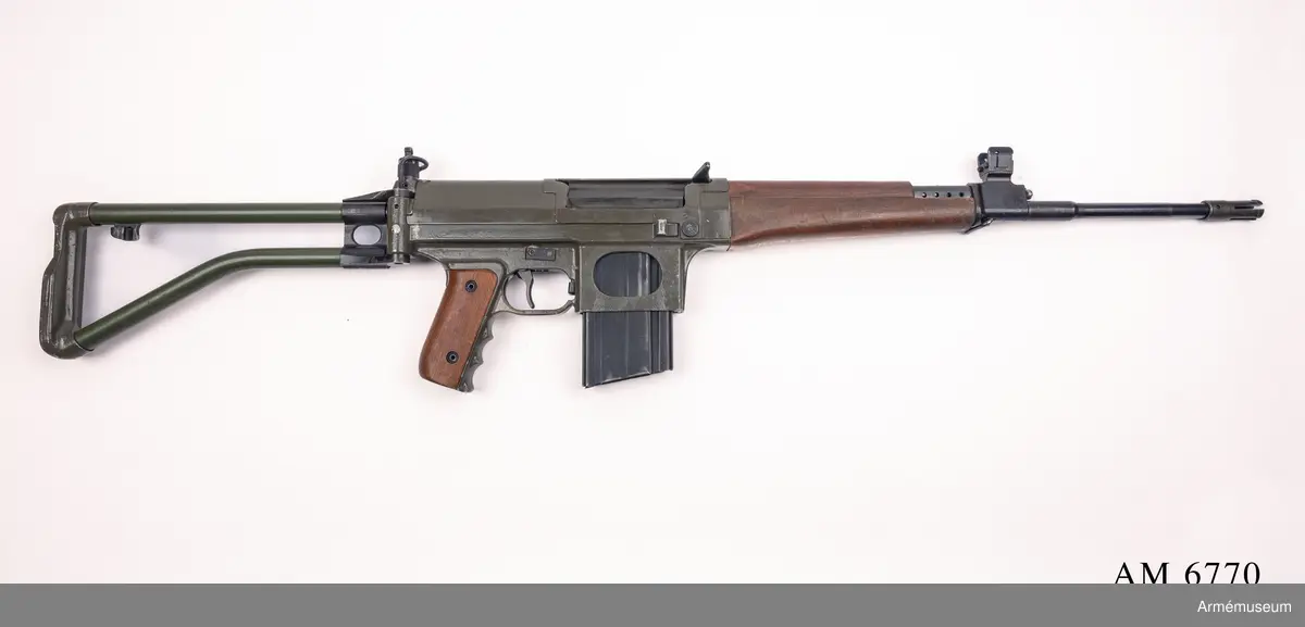

Here are a number of the fm/61 Gram listed in the Digital Museum :
If you look at the fabrication and design of parts back then and compare to this AG43 - the AG43 parts around the end of the hand-guard look like they where more recently made, except maybe the sling band

You are absolutely correct - they changed to 7.62x51 NATO and the larger 20 round magazine on some of their test rifles. Again, if you look at the details of how the rifles was made - around the gas block for instance - something is wrong if you compare the ag43
