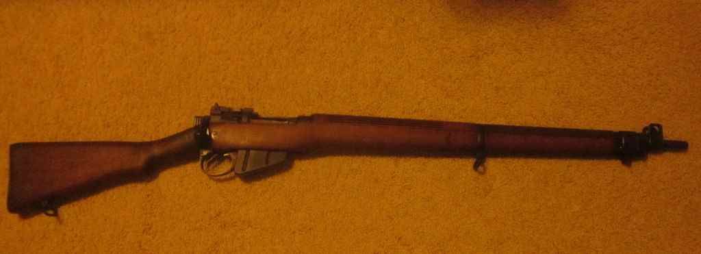

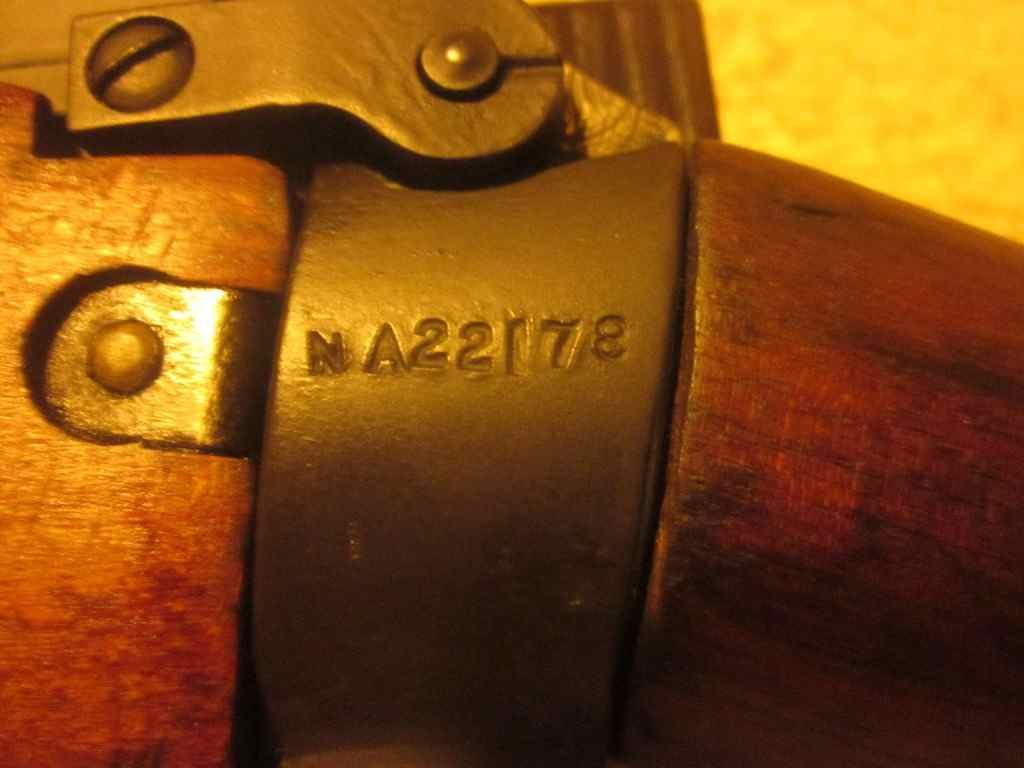

What can you guys tell me about this one. The sellers pics aren't the best. It doesn't have the usual year and maker marks on the wrist - it's been scrubbed. It's definitely been thru an arsenal and repaired/refinished and I'm assuming that's where the maker and year information was scrubbed. The Serial number on wrist of stock matches the magazine serial number and the stock serial number. The seller says the bolt is unnumbered. It has a faint import mark and is also faintly marked .303 BRIT U.K. The bore is nice and bright.
All things being equal unless you guys say there's something hokey about it I am buying it tomorrow. The price is $225 so in today's market doesn't seem like a bad price to me.

Ok, I met the fellow after sneaking out of work early today...one look and I knew it was mine. He hadn't looked in the right place on the bolt - it too is matching. My guess - since I haven't bought an Enfield in 20 years I'd be interested in your ideas on this one, is that it is unissued after a rearsenal at some time. The S#NA22178 is on the wrist, bolt, magazine, and stock. It's stamped on the fore stock there 3 times for some reason. The bore is mint. I think it was a steal at $225?

Looks to me like the receiver has been scrubbed just forward of the ejector screw. It's either a refurb done somewhere weird or a US refinish. It certainly never came out of an Enfield factory with that finish. Still a nice rifle at a good price.

I wouldn't begin to know how to determine how many grooves are in the bore. I took the rear handguard off and there are several brittish nitro proofs and a crown 59 stamp so I assume it went thru some sort of refit in '59? It's definitely been thru some sort of a rearsenal due to the scrubbed receiver markings, also the follower in the magazine is from Savage. I see no FTR mark though on the barrell when I removed the rear handguard or anywhere on the stock.
The importer markings may tell something to some of you? very, very very faint at the bottom of the left wrist above the trigger is stamped IAC Alex Va and then on the left of the receiver by the vent hole is .303 Britt UK (two line, UK on the bottom).
-Edit- did a google search and found references (I believe on this forumn) to those markings indicating it was an Interarms import.

Dale, the receiver isn't scrubbed. I can't find a U mark like you describe but I can see where the original markings are now - helped when I saw some photos on the web on where they are on other Faz rifles. They are there. But they were most likely pretty light to begin with. The (I think) arsenal refinish is over the top of them and they are very difficult to read now even with a magnifying glass but I can make out No 4 Mk I F - but still there.
Mine appears to have the same finish as the one pictured here - though my Interarms stamp is much lighter and in a different place:

The FTR marking is there as well as I think the year but on mine it all appears to be on one line. They were originally etched like they are in that pic, but the finish applied now is over them so no amount of angles in a picture is going to get them to show in a photo - as I said, you need a magnifying glass pretty much for them to be visible. As for the import markings, I'm no finish expert but if I had to guess I think the finish was applied after they were - there is no brightness around the letters in the importer markings. As I indicated in previous replies, no I don't believe the rifle has been issued in it's current condition - it's too nice. The maker stamp on this gun is NOT in exactly the same location as those you picture. It runs along the top under the full length of the rear sight all the way almost to the safety - and one line, not 2.

Thanks AFVeteran..actually if I pull the safety lever back, I"m able to make out the full date stamp. It's the last characters on that line. This one is dated '44 not '45. I wish I could take some photos of those markings but my digital camera is not capable of taking magnified digital photos good enough to be readable.
This is about the best I can do but you can see the markings are there and the date '44.
