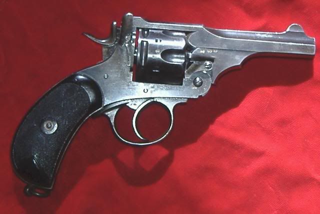

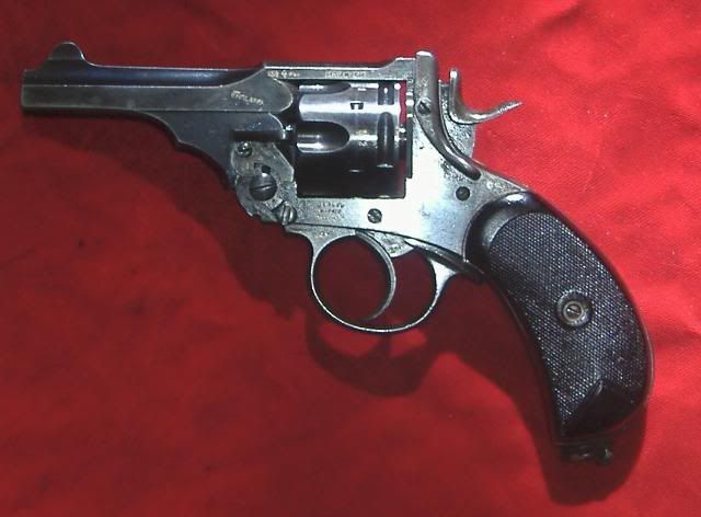

WEBLEY MARK IV
I'm new to WEBLEY'S
just got this one,the only bad thing is the cylinder has been cut for 45 auto or it can be a good thing
HOLSTER, GUN SOCK , AND BULLET MOULD
some of the markings it also came with 3 new screws to replace the ones that are buggered
I also ordered this http://cgi.ebay.com/ws/eBayISAPI.dll?ViewItem&item=140286644854 so I can shot it
