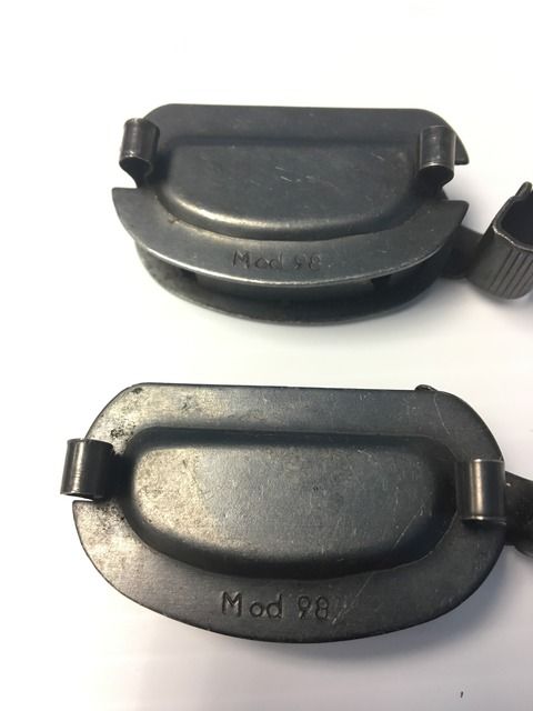

I have used the search function and tried to do my homework on K98 winter trigger devices. I was at the Lakeland FL show a few weeks ago and an old timer with a ton of Mauser and K98 rifles, stocks and parts had a parts bin with a few of K98 winter trigger devices. I own a nice bring back K98 but know little about it or these rifles. I suspected that they were reproduction and inquired. He responded that he does not think they are reproduction as he has had them for a long time. They seemed way too nice to me to be original but I thought they were cool and was able to buy 2 of them at a reasonable price. He did have an amazing amount of untouched and unmolested stocks and barrels (including some with the original sight hood).
I have not seen any dealers selling the reproductions. I know SARCO sold them at one time. I think the markings on these suggest that they are reproductions. I am just curious if you guys can confirm so I know before I label them and put them in a box to be opened by my grandkids. Any help would be appreciated. Thanks.
I'll allow others to comment to the authenticity of this piece and only note that I recall replica/fake Mauser winter triggers being sold back in the mid '70s. And it wouldn't surprise me to learn that like many other pieces of German and Nazi militaria, the reproductions were being produced a good ten years or more earlier.

100% repro.
Used to sell for $18 at Sarco.

yea repo. got some pals scrounging in Europe a few years ago (i got ammo crates if anyone wants em) you could get cool weird NON-GUN stuff. like mauser rifle racks for a kubelwagen,,Ect.... so.. i got a few 'grave dug' examples, and put the best together with a spring from a repo. ALL ive ever seen 'real' are rusted pretty bad. and you have to 'fit' it to make it in any way accurate. the only plus is your squeezing the hand not 'pulling' the trigger. but it shoves your hand and thumb back into the nose area, AND removes the safety feature of the Trigger GUARD. Heres pics
