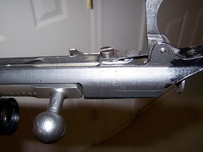

Out at the range today and was speaking with a buddy... Asked him if he knew much about improving the trigger on the 91/30's. Not much, he replied. The fellow said that I should just put some shims in between the sear spring and the receiver. Doing that would decrease the weight of the trigger pull. What good advice indeed! After scrounging around all over the apartment, I was coming up short on material to work with. Tried to cut some shims out of the body of a soda can, but it just wasn't enough material to affect a good reduction in trigger pull. After brainstorming on it a bit longer, I decided to try sticking the pop-top from the soda can in there instead. It might work for you, and it might not work for you. Results will vary, right? Mine feels MUCH better after doing this, and it also breaks more crisply. Has anyone else done something like this before?
