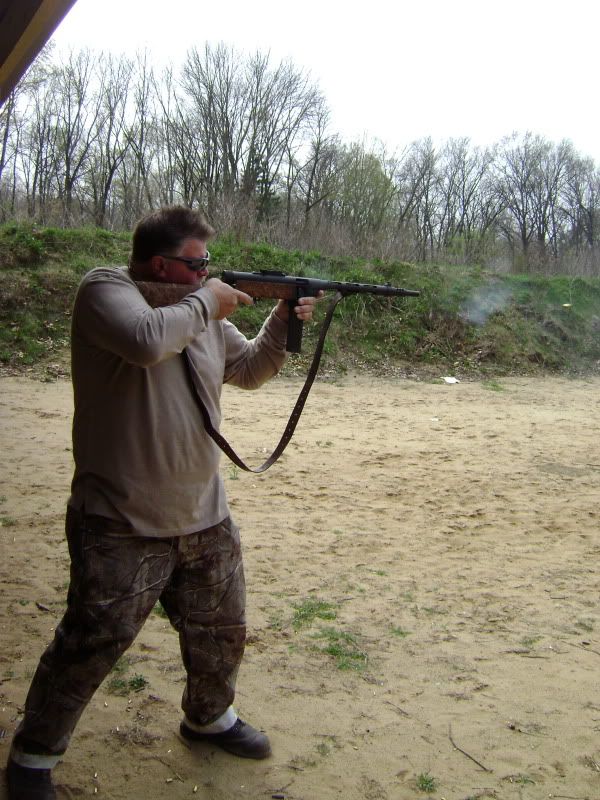

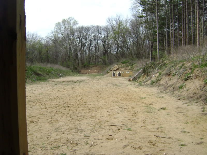

Bought a Suomi awhile ago, and finally got to get to the range. Its a heavy gun, almost no recoil. Its a pleasure to shoot, I could have shot this all day. It ran well for about 150 rounds then started to jam. I noticed that the bolt is parkerized, i'm thinking as it heated up it started to stick. I might try to polish it and see if that helps. (any imput would be appreciated) I was using stick mags and coffin mags. I like the quality of the build, parts fit well and the welding job is very good. Im glad I bought it. Here is the Suomi, and me shooting it at my range. It was a fun day.

Great looking stock! Here's a couple of things that helped mine. Make sure the barrel shroud is tight to the reciever. There is a set screw on the left side of the receiver that can back out. Polishing the bolt were it contacts the reciever and where is rides over the magazine can help. You may also want to polish the parkerizing off of the chamber.

Great looking stock! I agree with the comments said so far on the parkerized part friction. How long is it going to take before someone strips all the parkerized finish and does a nice blue finish on one of these? I'd like to do that with mine someday and it would look much nicer for sure.

BTW, Swissrifles, thats a nicely figured stock you have!

I think they are parkerized because the outside of the receiver possibly would show weld marks from where they reattached the parts of the gun back together?? I too think it would look better blued, but that was my hypothesis. SwissRifles- I thought I had a nice stock- yours is great!
