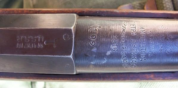

Does a '22 Tula with the crest on the recycled receiver peened before the Tula hammer applied count?
It could be like the one I posted. I am considering calling ones like that unscrubbed because the Soviets did not scrub the Imperial Eagle from the barrel. As to yours, after the revolution, I'm not sure where to put it in this survey.

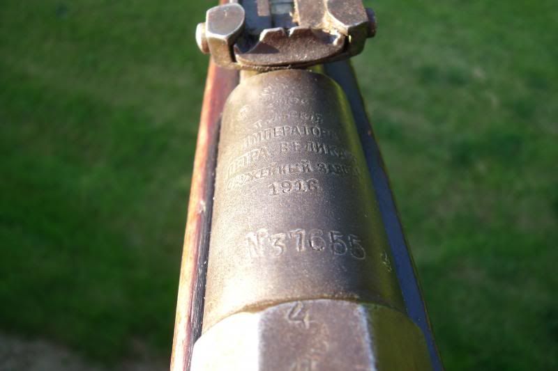

I'm convinced that the "dished out area" just behind the rear sight is an attempt to solve the high shooting often associated with M91s, especially when (front) sights are swapped around. It often allows the rear sight slider go down a bit further. Just too deep, at too steep of an angle, and usually not all of the stamping is removed.
Seen on some Balkan, Finn, and SCW.

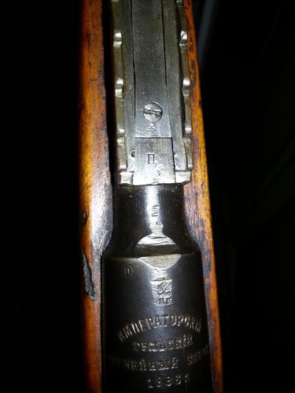

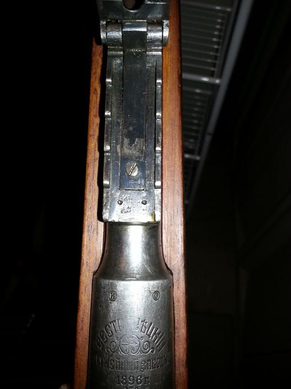

Perhaps I should have been more specific with the term "dished out" area. I am not referring to the area ground off at the front edge of the barrel shank. There was another Balkan related thread where this was also discussed, and I agree, it must have been ground off to allow the rear sight to sit lower. Which is why I believe the Balkan countries peened in to place the "Balkan wedge" in the rear sight. Allow me to show an example to illustrate this.
With the Balkan wedge:
Without the Balkan wedge that was removed or fell out somehow and also has the front edge of the barrel shank ground:

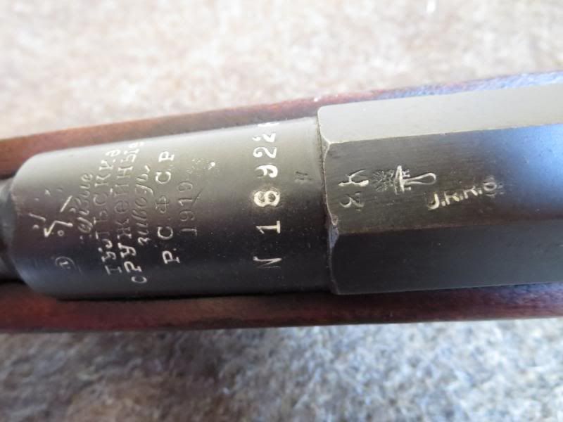

By the dished out area I was referring to was a sometimes seen machined out "dimpled" area on a top receiver flat of recycled receivers the Finns used when they made their own models.
