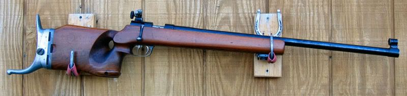

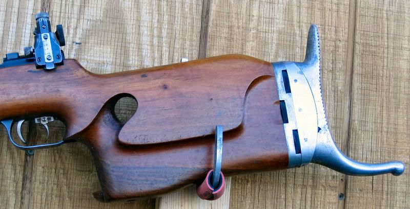

This is my Schultz & Larsen Model 61, a veritable behemoth at 14.5 1lbs, 1" diameter, 27" long barrel. I believe (someone correct if I'm wrong) that the M61 meets the international specifications for a "free" rifle. Schultz & Larsen referred to it as a "Skyttegevær Kortbane", short range rifle. Mine did not come with a hand rest, but maybe I'll stumble into one someday. The rifle was a direct development from the Nr. 45, 46, 47, and 49 target rifles. Production began around 1959, but it is not known how many M61 rifles were made. It was a fairly prominent rifle in free rifle competitions during the 1960s and 1970s. The hand rest itself is a marvel of woodworking craft Adjustible set trigger. I haven't put it through its paces yet, but once I find my zero, I will shoot it at 100 meters and see how it does.

Mine is an early production M61, serial number 2002. Later on S&L changed the rear diopter and mounting system. The Parker Hale sights would have to be an add on since S&L mounted its proprietary diopters on these rifles. The M61 is a direct descendant of Niels Larsen's M45, M46, M47, M49 series of .22 rimfire free rifles. Production began around 1959 and probably continued until 1970. They are still listed in the 1968 and 1969 brochures and catalogs. Total production numbers are unknown and it is difficult to speculate on. The centerfire version, the M62, only about 370 rifles were built, but I suspect that quite a few more rimfire M61s were made. Some of the M61 ended up being used by shooting clubs in Denmark. It is unknown how many made it to the USA. To remove the bolt you unlatch the small tab/lever on the rear of the left side of the receiver. Oh yeah, my m61 weighs in at a little over 14 pounds.

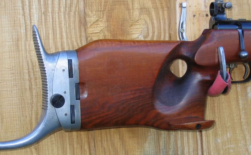

And old review or two in American magazines. Some information in the Danish language S&L book, but not much technical information. Flipping the lever open should allow the bolt to come out, not sure why yours doesn't and it will be Monday before I can get to my rifles. Mine has the hand rest, but I took it off for picture taking purposes.

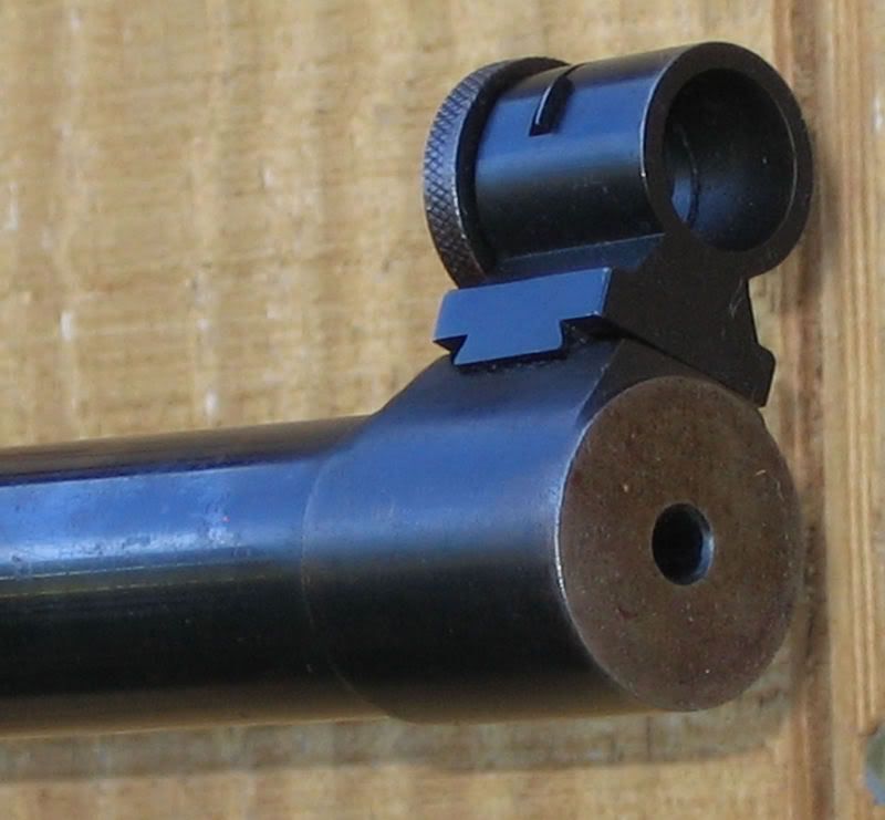

There's not much info on these rifles that I can find, so I'll add mine here as well. It has a different rear sight than Kriggevaer's rifle, so I guess it's one of the later ones. It's got a dovetail on the side of the action that the sight bracket slides into.
Mine has the 1.5 oz trigger, and it takes a bit of getting used to after shooting anything else. If I ever find it's big brother M62, I'll definitely have to add that to the collection too.
