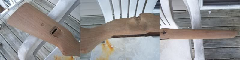

Its amazing all of the problems one finds with a stock after all of the cosmoline, grease, and dirt comes off. I am refinishing (and eventually glass bedding) a sporterized Mauser stock, and it is PAINFULLY obvious that this stock lived a very hard life before I got ahold of it. A crack in the fore end, and a crush mark around the grip. I started up with it last night by stripping off all of the gunk. I applied generic brand oven cleaner and let sit for one minute and then scrubbed it off under hot water using a green cleaning pad. For the rest of the process I boiled the stock in a large pot. I have a 16qt stock pot that I use for canning and was only able to fit the front 1/3 and the rear 1/3 of the rifle in intercahgeably. I used a turkey baster and a green scrubbing pad to get the inbetween 1/3. That stock finished up with NO trace of oil or cosmoline on it anywhere. Sanded with 120/220/340 sand paper, applied a pre-stain, and then four coats of stain over the course of the morning. Later tonight, the first application of Boiled Linseed Oil will be applied. The stock wasn't much to start with, but its a good place for me to start having never re-finished a stock before. More pics will come after the stain and oil have been applied.
-thomas
Here is the stripped stock... Sorry about not taking any before-before photos for comparison of all the crap that was removed....
