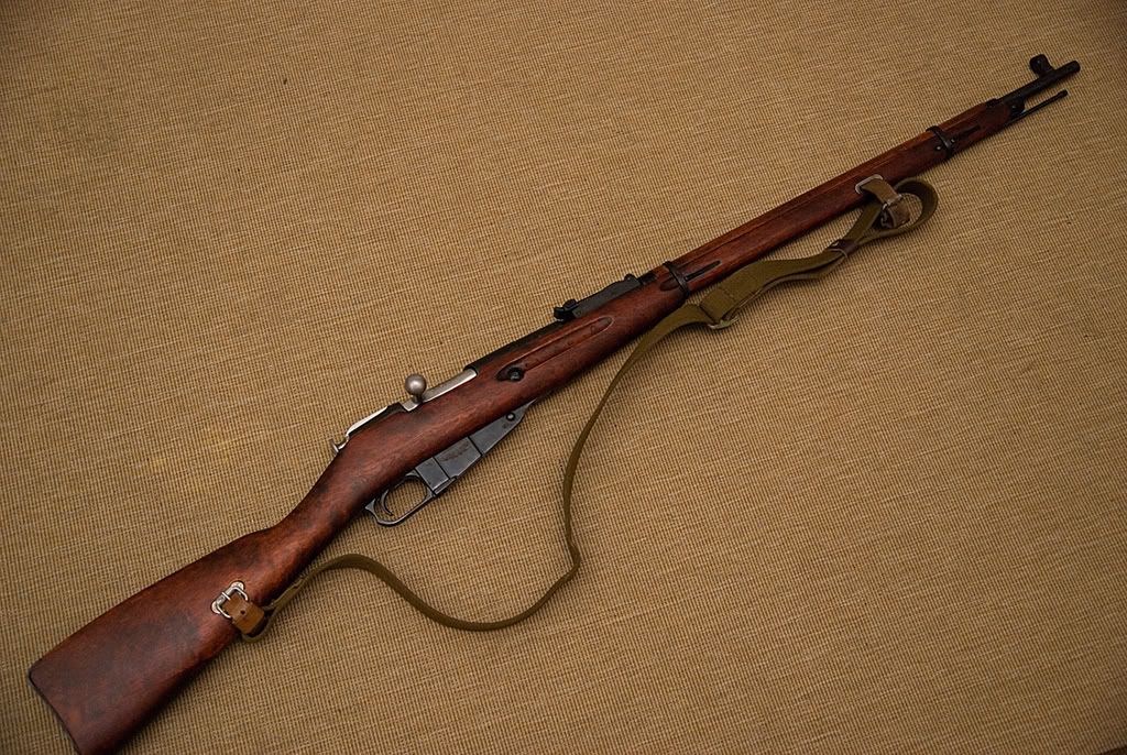

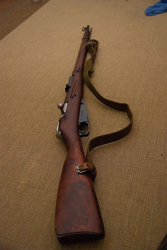

First take denatured alcohol and steel wool to strip the shellac and gummy feel from it. After this i sanded it down with 80 grit sand paper to the woods natural state. from there I went to 150, then to 320.I then sealed the wood with 3 to 1 tung oil and alchol. I then used minwax red mahogony. this color was way too blonde. I thought it would be alot deeper color. So I went to the local saddle shop and picked up some fiebing's medium brown leather dye. rubbed 4 coats of this on then let it sit for a day to soak in. After this I applied 4 coats of tung oil to finish it and the last one I sanded in with 1000 grit sand paper.
Originally the wood loooked very simialar to this:
http://www.davesguns.com/serverpics/UsedPage/Mosin-Nagant-Long-01.jpg

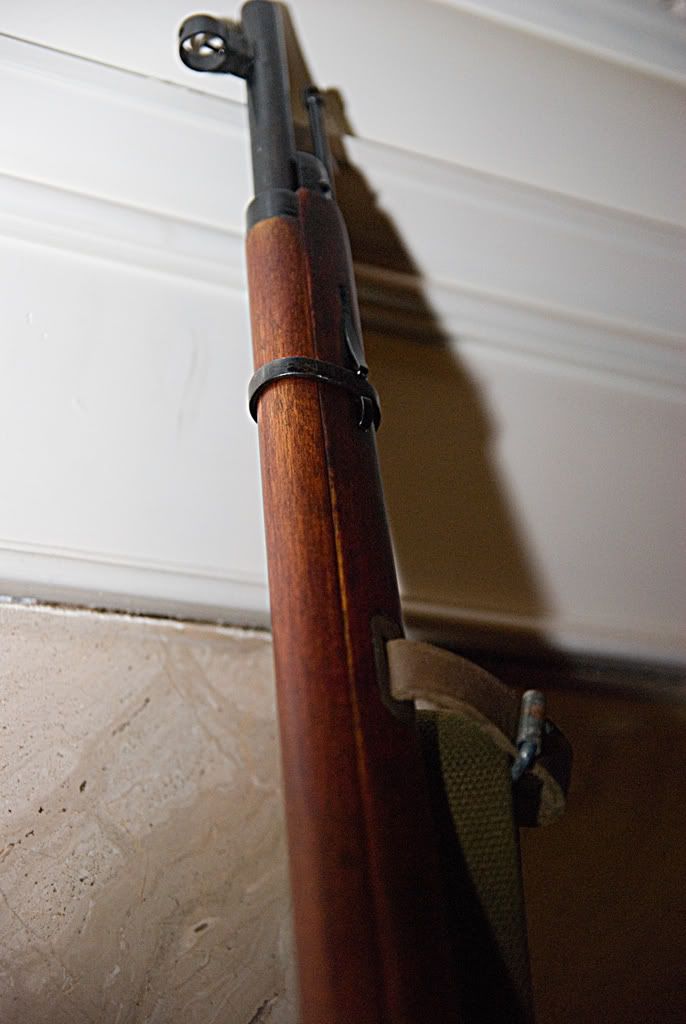

It was in worse shape though. Dinged up and very sticky for some reason. I chose that color to hide imperfections. That slings giving me fits what needs to be done? Besides making a new hole in the fore collar to make it tighter?

backwards indeed. that's probably why the damn collars aren't fitting correctly. thanks guys I'm very happy with the finished product. Hope it shoots good. if it was counterbored would this be very visible? I can't decide if it is or isn't?
