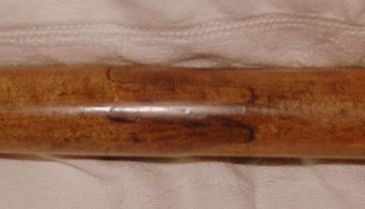

Sometime back I bought a M39 dated 1942 with a Sako barrel and the bore is mirror bright. But the blond stock definitely shows signs of having been used in a less than friendly environment. The dents, scratches and etc. were not sanded out but lie below some sort of finish which is not shellac.
My question is if said finish was applied by the Finns what would it likely be? It appears to be BLO or even poly done by previous owner or the importer,which was Inter Ordnance (I/O).

That doesn't look natural to me. Looks to me like someone purdy'd it up at some point after import.
