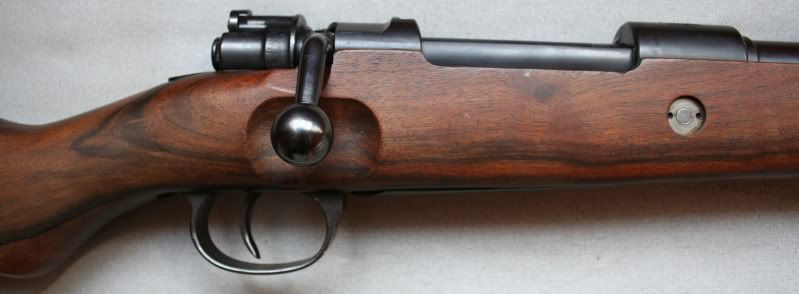

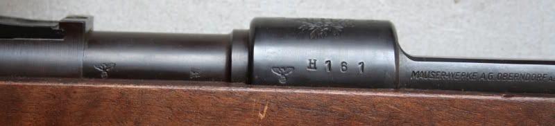

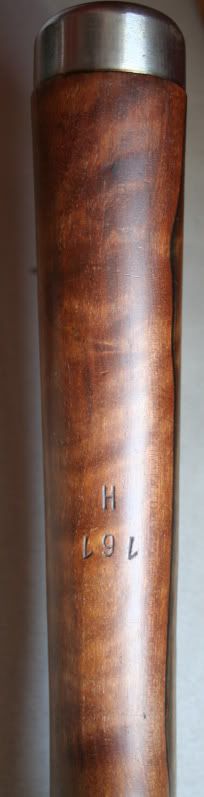

The metal and stock have not been refinished. Now the stock is interesting in no external Wamts or internal SN.
My best opinion is that the stock is a period replacement, possibly even replaced by the Portuguese.
All factory M937b (commonly referred to as the M1941) K98ks from Mauser will have external military acceptance stamps, with a large final
acceptance sequence on the side, and 2 smaller process stamps on the bottom, and a matching serial stamped in the barrel channel.
Very nice and interesting example.

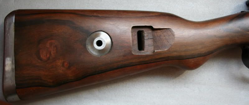

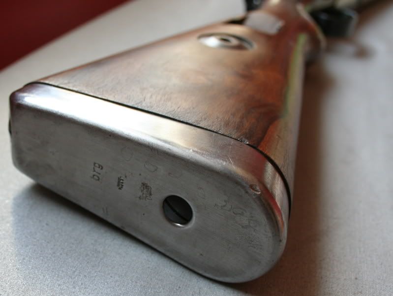

OK, how about something a bit different? I'd like to report Port Crest 1941 F 5793, but only the stock assembly! It's a stock, flat buttplate with Port Cross, crossbolt, and bayo mount only! Stock channel, bayo mount and buttplate serial numbers all match. Shows e/655's throughout as well. Definitely German usage as it came off an RC. The question is, who has RC Port Crest 1941 rifle F 5793? Did the barreled receiver survive?

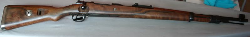

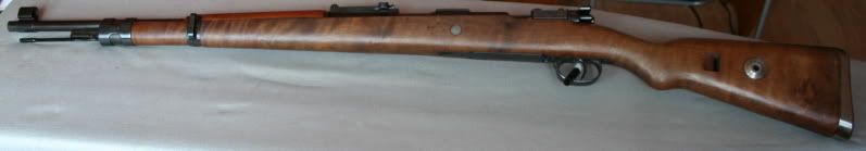

Thought I'd post a special interest rifle of mine that has been discussed privately with several Forum members in the past. Portuguese 1941 all matching & unissued, mint condition with original factory grease/cosmoline still present in areas. Serial# H7931, all inspection stamps in stock/metal are deep/sharp. Mint serial# matching bayonet and sn# matching scabbard. The bolt on this rifle probably has not been racked more than a couple dozen times at best, amazing Mauser-Werke factory condition that has not been collector messed with in any way. With the exception of very minor staining on stock and butt-plate, it is hard to believe this rifle is 73 years old. No import marks on this beauty, but is loaded with Nazi inspector's waffenamps.
Wow, next time I insert pics I'll be more careful! Pics are not great, but you get the picture, enjoy RP.

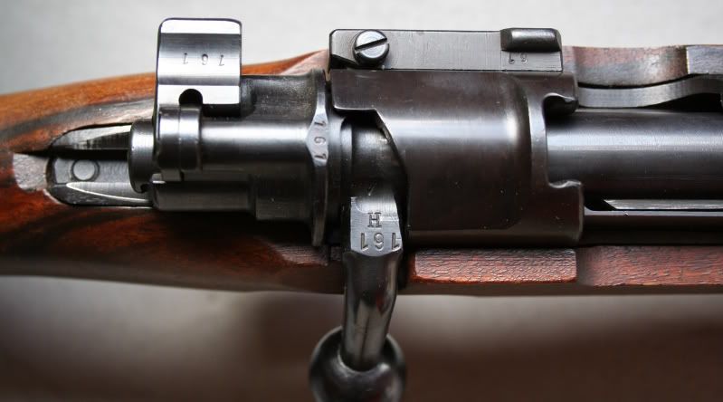

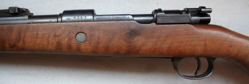

I know this is a cold thread, but I figured I'd bump it with my recent acquisition of a G-block 1941 contract.
The serial is G18037.
The barrel, receiver, floorplate, follower, trigger guard, action screws, trigger, and rear sight parts all match. The stock and stock hardware do not match the action but do match themselves. The bolt is a mismatch, but the bolt body is only one number off from the stock. All German markings are clear and present. There are no import marks visible, though I suspect it is a GI bringback.
Here is an album of pictures from the seller I got it from.
1941 Portuguese Contract Album
