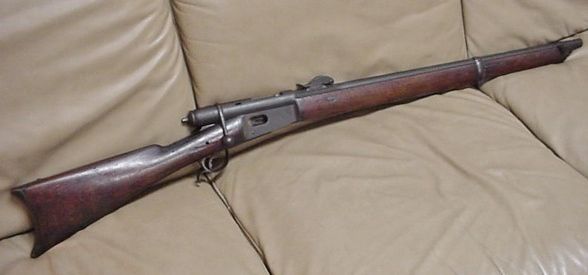

parts are out of ultrasonic

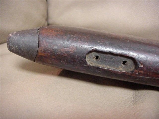

stock all cleaned up, the forearm was shorten already

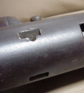

bolt head was already drilled with too large of a hole, I'll probably tread the bolt and put harden screw in it then redrill to a proper size
the striker has been cut down, so the home made firing pin would work, so i'll have to drill the striker and put a drill rod in it for a firing pin
may make this into a carbine seeing that the barrel and the forearm has been cut already

I always wonder why people would cut down such a fine rifle. I suppose someone thought a few less inches would make a big difference.

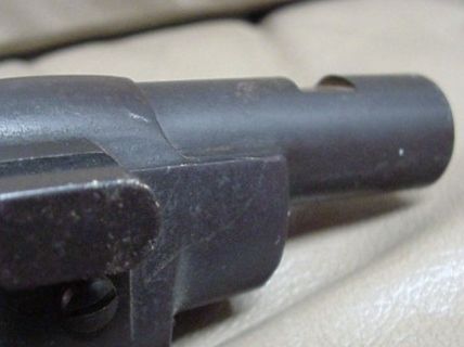

found my miss placed 6mm bolts
drill a hole in it
cut it down , and counter sunk it, this will be screwed into the bolt first, for eases of placement of the firing pin
didn't have any red Loctite, so I used some medal epoxy , made for gun smithing
after it dries, in about 12 to 24 hours I will mill the bolt face a little
also I will cut the firing pin back a little to proper length
