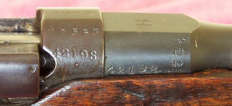

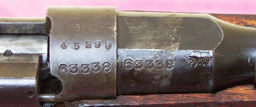

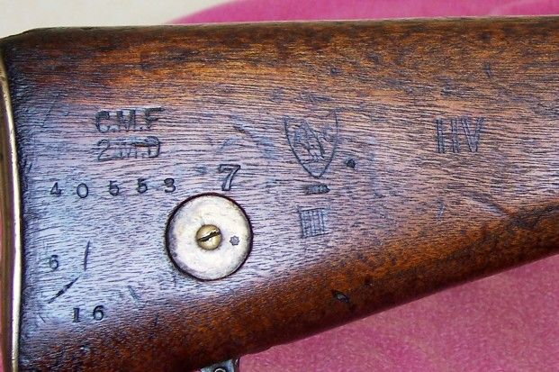

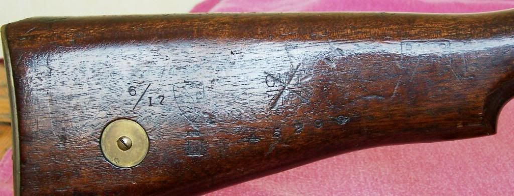

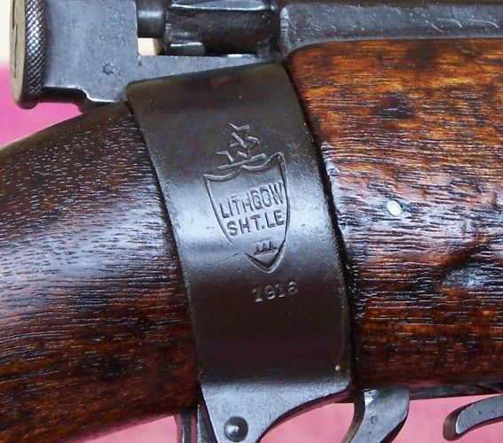

Yes muffer you'd get no argument from me with that and of course it's well known that the factory production figures quoted in skennertons books are to fiscal years. I run my piss poor business the same, but this is only production figures for numbers of completed rifles and makes perfect sense for the factory in order to balance the books. The question is, are action dates in line with the fiscal year or calendar year? I saw that you already commented action dates were in line with fiscal years. I'm not disagreeing but that's the first time I've heard that and surprises me some what.
2,050 Posts
Just eyeballing the production figures for 1917 by month, jan.1420, feb.1740, mar.2300, apr.2680,may.2810, jun.6290, jul.1330,aug.1640,sep.3060,oct.3029,nov.3046,dec.2900 = 32245
The accumulative total to 1917/18 is 96257, 3742 rifles short of the 1918 A prefix.
Looking at two rifles that are relatively close , 1916 and 1917 I calculate the 1916 to be around Mar.'16 and the 1917 around Nov.'17.
If the rifles were dated per calender year, they'd both be 16's. My '14 would be a '15.
· Silver Bullet Member
3,859 Posts
Mate you lost me a bit there. You wrote, 1916 to be around Mar 16 and the 1917 around Nov 17. Sounds right to me. Whats the serial number of the rifles?
Ive done similar calculations before but the numbers don't add up to me. I could be completely wrong but the figures don't seem to be in line with the butt dates on my rifles. The grey area for me is number of rifles assembled up until June 1914. The calculations would put it at around 12000 but I think its about 1/3 this figure. Its been a long time since Ive done this muffer so not remembering exactly how I came to that but Id be very interested to know the actual figures if you have them. I had also determined that action dates changed from 1916 to 1917 at about serial number 58000 at the beginning of 1917.
2,229 Posts
Lithgows fiscal year ran from July to June (according to Ians books) so any rifle with a date on the butt (early rifles) that is marked 6/16 or 6/17 should (if the actions were dated fiscaly) have the date 1915 & 1916 respectively on the action.
2,050 Posts
My bad Demo, that '17 was Nov.16, I'll blame the dog for that, she gets a bit touchy when I don't take her out when she asks. (No Bindii, not my wife)
12000 is definately incorrect. Up until 30 june there were only 4800 according to Skennerton, the actual figures look more like 13800, but there are two batches of test rifles not recorded in these figures, and this includes the 6 months to Dec. '15. the accumulative total being 18,586.
There would seem to be a variation in calculations between the Official Reports, Skennerton and Griffiths, Reynolds and Stratton have different figures again. You will also notice the Jun.17 figures I quoted virtually doubled, possibly because of a pause in the barrel setters strike, but definately an anomally in respect of other months.
The percentage of rifles actually issued is another matter, 12/13-40, 13/14-3,900, 14/15-14,646, 15/16-30,420, 16/17-22,670, 17/18-23,570. = 35,246, against a total production of 96,257. the remainder to store.
