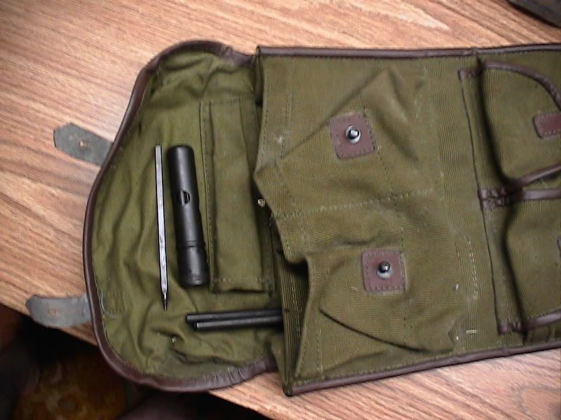

You might have lost more than the mag pouch as the one that came with my rifle had a spare firing pin,cleaning kit and rod in the cover flap.
the only brass I found was a box of reloadable Hotshot ammo I pulled and reloaded and Lee dies were All I found . Does anyone crimp this round ? As far as the fireing pin I didn't get an extra but I did get 2 scope coats . and some other stuff (pic later)
