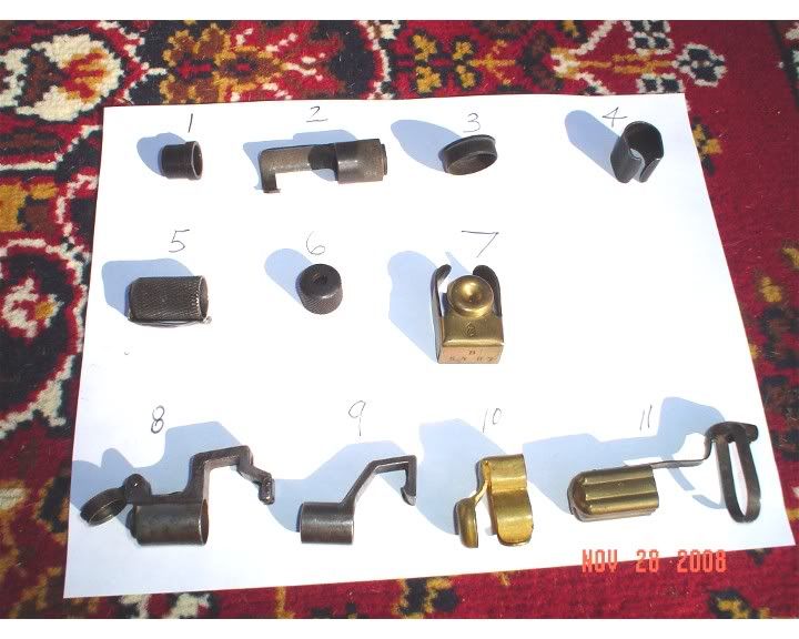

Hello, Not sure which board to put these on..but here they are. I need help Id'ing this lot of muzzle caps. I know #11 is for the Swiss 1911 and earlier rifles, and I think #8 is for GEW 98 rifles, and is numbered. Found out that #5 is for Finn mosin nagant. THANKS in advance for all the input! #1 and #3 are rubber, rest are metal or brass.

MUZZLE CAPS:

#2 is a Mosin Muzzle Cap
#4 is a G 98k sight hood for later 98 k rifles
#5 is a Finnish Mosin Nagant Mod 39 M Cap
#6 is a M/N cleaning guide, if it has a plate it is messed with
#7 is Argentine Modelo 1891 Carbine M/Cap
#8 is a generic 98 long rifle M/Cap
#9 looks like a Norwegian Mod 1912 Muzzle Cap
#10 is for the Argentine Modelo 1891 Rifle
#11 is a Swiss Mod 1911 or maybe a Mod 1896 M/Cap...
My best guess......
Dale

Based on the newly submitted closeup I withdraw my ID as Greek 03/14 -at least the detail of the hook portion does not match my 03/14 m.c.
I dion't think it is for a Norwegian M12; there's nothing like it in Hanevik.
Perhaps Serbian/Yugoslav?
You were right the first time. It's for the Greek Mannlicher-Schoenauer rifle (and the carbine with the front sight that does not have the four-eared protector).
