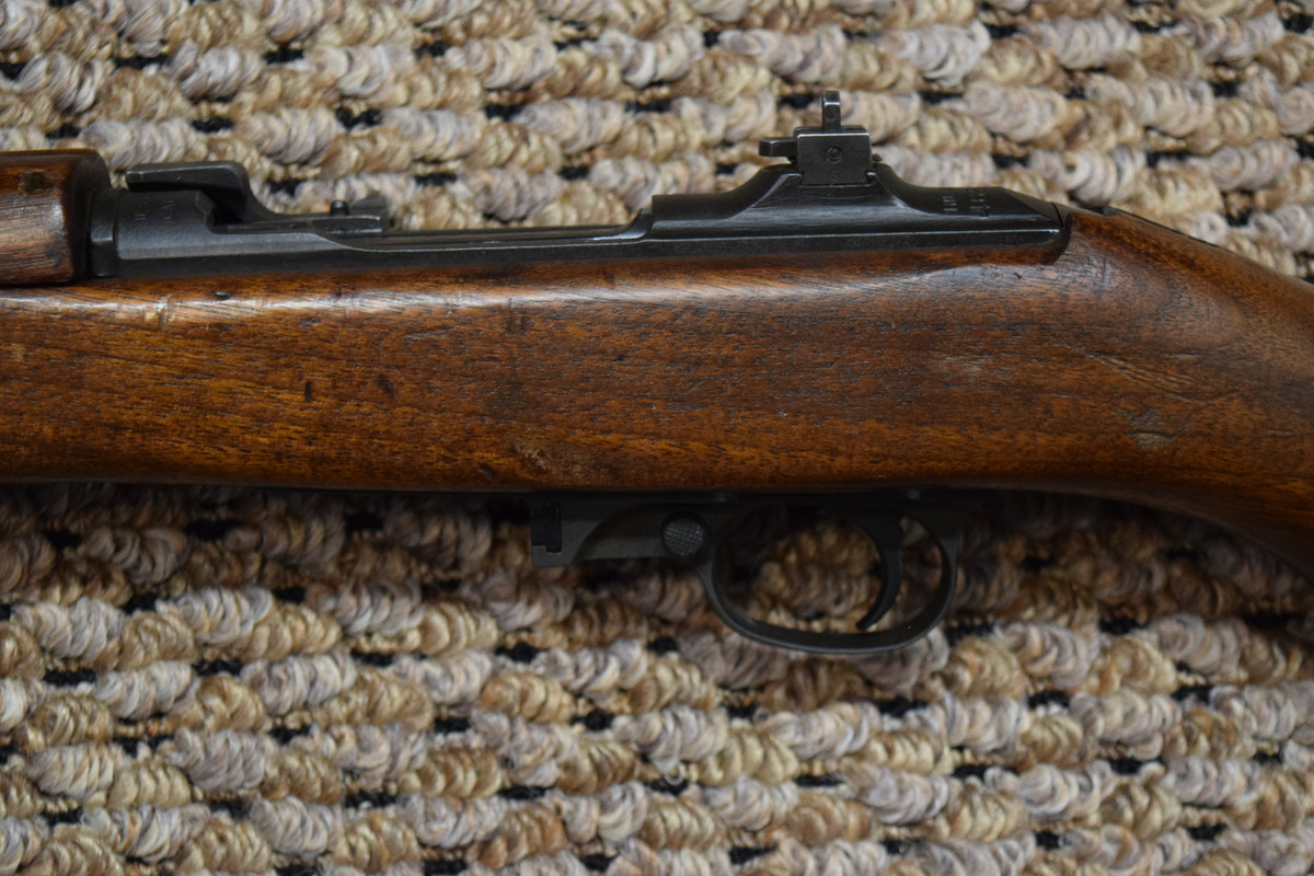

Found this locally for 1k. Going to pick it up this weekend but figured I would bounce it off the forum to see if I missed anything. Was sent back to the states in 1945, been in the same family ever since. The only thing that threw me for a loop was the darker almost black finish, although it could just be lighting. Everything else appears to be correct but I dont have another one to compare it to.
thoughts?

Pics 13-15 show what looks to be a more correct color, parkerized green. It does have the early front band (no bayo lug).
Inland, correct? Stock looks like a pretty high sheen for boiled linseed oil finish, but otherwise, looks nice.

I think it might just be the lighting. I wonder if they kept it in original configuration. I think it’s a ‘43 Inland. This site lists some things to compare how it is now vs how it left the factory, as opposed to “all matching”.

He said its as it was in 1945 was sent back in parts reassemble and has seen about 400 rounds over the last 40 years or so
198 Posts
First, the finish appears spot on for an Inland carbine of that serial number's time frame. The stock is for sure a late Winchester. The rest could be Inland parts, but if the stock is not original then the rest doesn't quite matter as much--although it's still a nice looking carbine.

The stock appears to be an IBM stock as the crossed cannon are quite away forward on the stock. Could be Winchester but the only way to find out is to look in the sling well for letters if any. Other then the stock the carbine looks very good and will be a great pickup.
The wide, flat fore stock is typical Winchester. Also, the W in the sling well is a dead give away. Winchester stock, for sure.
