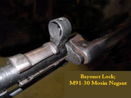

It didn't want to mount on my rifle right off; had to take the emery cloth to the inside of the socket and a file to the slot that locks around the front sight base, but we got it on after a while.

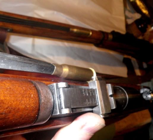

A Dealer had told me that sometimes the Russians would reverse the bayonet, laying the blade along side the stock much like a folded M-44 bayonet when it's retracted.
Once I wrestled the bayonet on, it was very tight and resisted attempts to remove it. As I was wondering about what I could use to give me some leverage, I happened to think of the screwdriver/firing pin protrusion guage that comes with the field kit. That has an oval hole in the handle that might just work. So I rummaged around until I found it, and "Violla"! It slips down the bayonet blade to the socket where the large end of the egg shaped hole just barely catches on to the end of the barrel where the muzzle extends beyond the bayo socket just a little.
Wrapping a rag around the narrow end of the tool which is now used as a "handle" or lever, I lifted up while pushing the lock button with my finger. It lifted the sticky blade right up in front of the sight where it could be slid forward and off of the rifle.

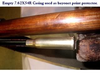

With the blade reversed the sharp point faces backwards, and a shooter could get a nasty jab out of it if he wasn't careful. The idea struck me that perhaps the Russian Soldiers used discarded shell casings to blunt the point of their bayonets when they were not in combat for their own safety as well as that of their Comrades.
Just for the heck of it I fetched an old Berdan primed empty and stuck it on over the point - and it stuck right on to the tapered blade just like it was supposed to. The quadrifoil blade forces the case neck into sort of a square and gives it spring tension for a firm friction fit.

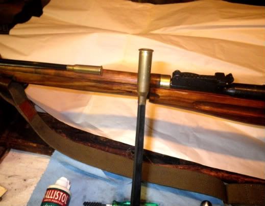

Out of curiosity I got out my M-44 Carbine and extended the bayonet on that. After pushing a case on to the end of the blade I pointed it down to the cement floor of the shop and gently tapped it a few times until I felt the tip bottom on on the case head. That stuck on really well but could still be removed by hand.

In the picture I just used string from a cartridge bundle to illustrate the concept. Before test firing I'll probably replace it with rawhide, artificial siniew or tennis racket string so I won't have to chase my bayonet down range. I'm also going to wash my bayo socket thoroughly after using it as a brake with corrosive ammo - same with the blade if fixed while firning.
