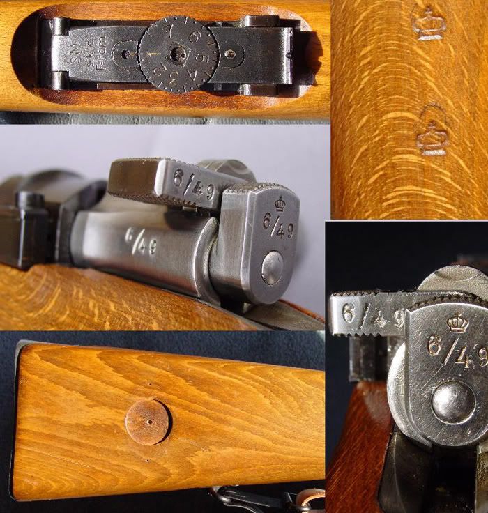

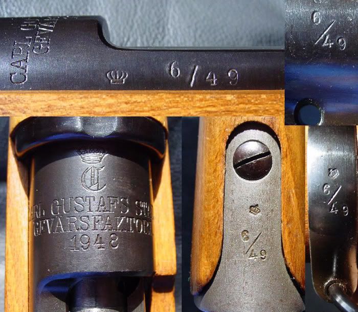

I bought this unusual M/96 back in 2003. It is an armorers rifle with a receiver date of 1948. It's the latest dated M/96 that I have seen. I'm not sure as to what the serial number relates to. My guess would be the sixth rifle in 1949, or the sixth student armorer in 1949.
The stock is especially beautiful with great flame. The disc hole on the stock has never had a screw in it and you can see where there was at one time a oval plaque over it. The rifle has it's serial number all over it including the underside of the rear sight (not pictured). I consider this rifle the the premier rifle in my Swedish collection. It is not import marked as it was a private import.

I am guessing this is some sort of commerative gun, perhaps the anniversary of a special date in the Carl Gustaf Stads factory history? The Weapons Officer's guns are marked in a completely different manner.
When Husqvarna was celebrating the 300th anniversay of their founding in 1989, they made several series of commerative guns marked like this one. I have a shotgun marked 24/75 which means the 24th in a series of 75 made. They did the same with a series of bolt action rifles, and another series of higher grade shotguns.

That makes two beauties that I have seen in 24 hours. Very nice, whatever its purpose may be.
Moderator/Diamond with Oak Clusters Bullet member
8,976 Posts
Steve : This is not an Officer's Weapons rifle . Jimmy has it correct , an armorer's rifle . See another example in Crown Jewels , page 77 , photo #155 ( 29/51 ) . It would be the 29th student ? , apprentist ? armorer in 1951 . A big class that year , as another is numbered " 170/51 " .

I stand corrected. Thanks for setting me straight.

Here are more photos of the rifle.

Too bad you don't have that plaque anymore that looks like it covered the stock disc hole. It might have given some valuable information.
