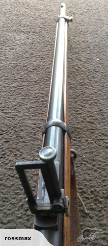

After the recent work on a Martini Enfield carbine (http://castboolits.gunloads.com/showthread.php?226756-A-Martini-Enfield-303-again) I had been itching to have - get - work with or on, a 577-450 and there seemed to be a suitable candidate on the local (NZ local that is) Trade me auction site. It was on for a few weeks with no visible interest that I put down to the horrible looking addition in the butt stock and a pair of holes d&t into the action sidewalls along with a very visible repair to the wrist and another to the forestock retaining pin.
These were the pictures accompanying the auction blurb
