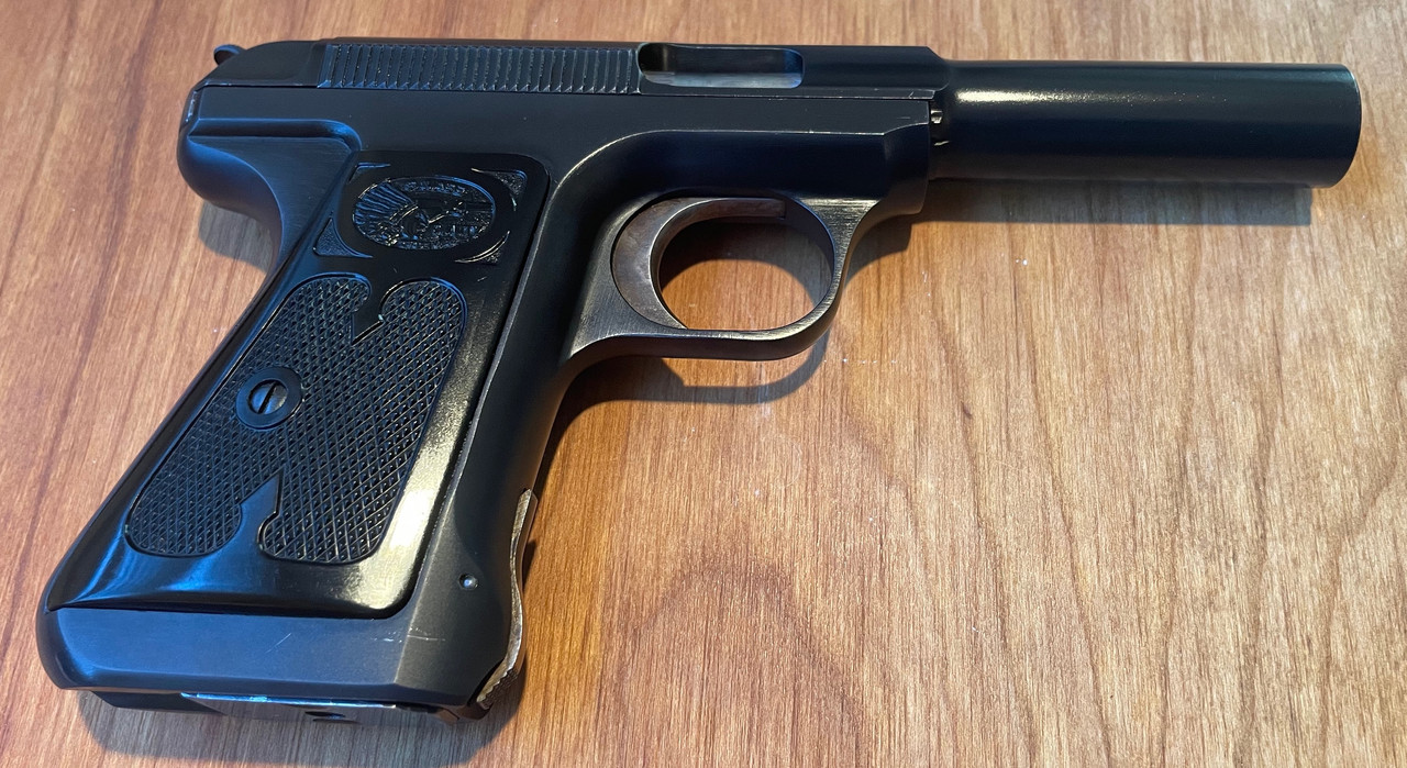

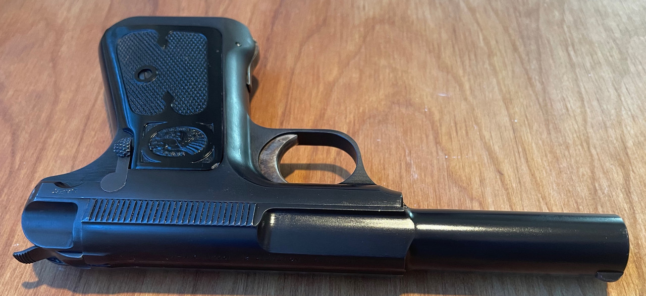

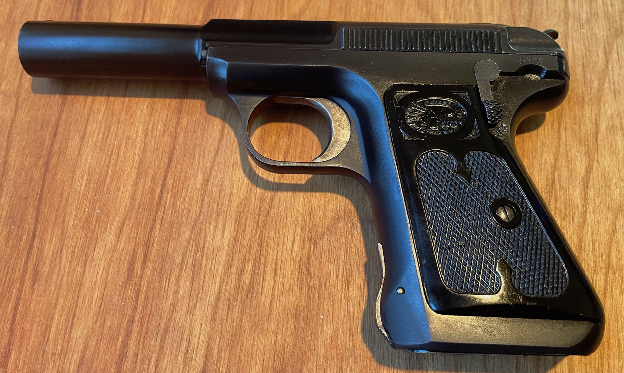

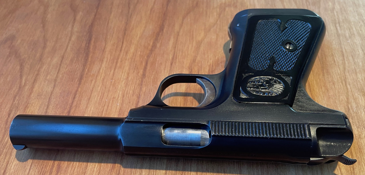

Hello everyone, I have a well-preserved Savage 1917 in .380 ACP and am trying to locate more info on these pistols. For some odd reason, there seems to be much more thorough information available online for the Mauser 1910 and 1914 than for the Savage 1917 (though there is a fair amount for the 1907).
Does anyone know whether there were any different variants of the 1917 in .380 during its eight-year production history? Or was it exactly the same pistol from start to finish? If the former, could you tell me what distinguishes the pistol in the pictures below from some other 1917s?
