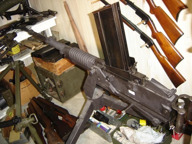

Jap. Type 93, 13mm; Hotchkiss design..... I have an extra DShK wheeled mount I had thought to adapt this gun to....tripod here is display only.
