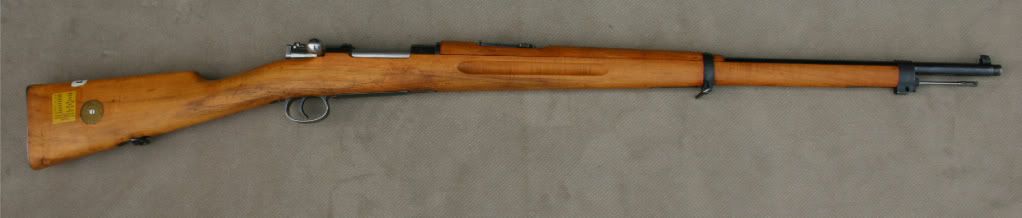

Opee

Opee. what's the s/n of your maple? I recall that I had two maple stocks that were about 8 numbers apart. Yours must've been the yellowish color while the other was a former FSR rifle and had been stained a brown. Knew I had photos of them.. One of these is yours.
Dutch
Dutch, My rifle pictured below is the same one in your picture with the yellow range decal. It is the one that came from Dana Jones Garage but came from you first. The same one that you were trying to find the buttplate for in your garage. I was visiting Dana and noticed he had some stocks in his garage. I picked out this one because it was unique, as well as a handguard that had the same thin tiger stripes and color. Later I bought a bunch of rifles from a Proxibid Auction and one happend to be a nice 1915 Swede unthreaded barrel with a nice black finish on the metal. Only problem was the stock had been slightly sanded, so I knew then that this maple stock was going to have a home. The stock serial number is 3674XX. You will notice the thin stripes are more profound around the handgroove area. Almost as if this stock and the one that sold yesterday had come from the same maple tree or forest?

Opee
That stock sure looks better. Tons better.
The two maple stocks, yours and this new one, are certainly very close. You'd have to lay them down one over the other and see if the fiddleback "bars" lined up. It's entirely possibly that they would given the closeness of the numbers.
How did you refinish your stock? The color looks very good.
Dutchman

Here are a few photos of my Maple stocked beauty. also made in 1915. Very close in S/N to the auction rifle in the O/P (195 rifles).

Dutch:
I just took the wifes iron without her knowledge and steamed out all the dents, then used a very light stain to get the proper color back and a couple of coats of BLO. The hanguard was already in good shape and the barreled receiver and new buttplate from the 1915 rifle all fit very nicely. So, if you look at the rifle from the outside, all the numbers are matching. But being the honest person I am, I will always let people know the stock number inside the barrel channel does not match, but the year is correct for a 1915 maple Swede. If I did not own this rifle I might have gone higher on the GunBroker bidding, but on the other hand, I probably would not have recognized the rifle for sale as being maple without first seeing and holding my own rifle in person..... You just dont see maple Swedes all that often, Opee
