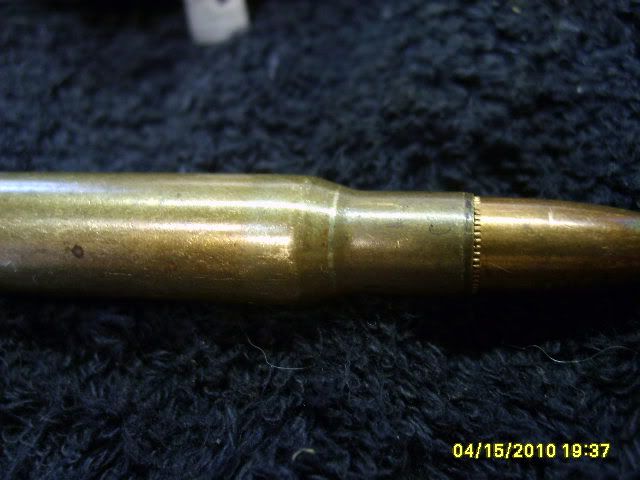

Last gun show I pick up a 1903-A3 barreled receiver. The barrel is new and short chambered but mfg is unknown in 30-06. This is my first try at finish reaming a chamber. I "guess" I went too far with the reamer because the bolt closes on my no-go guage, even though I only barely touched it with two revolutions of the reamer. I chambered a round and it closes nicely with no play in the bolt. I then put in a field guage and it does not close with the rear lug at about the 2:00 position. I then put 2 pieces of scotch tape on the round, that's about .004, and the bolt does not readily close without hard pressure squishing the tape. I believe rifle is safe to fire and just fishing around for a little advice. Also is a picture of the round and you can see on the shoulder where it mated to the chamber. Thanks

THIS IS THE ROUND I USED AND YOU CAN SEE MARK ON SHOULDER WHERE IT MATES WITH CHAMBER

If it won't close on the Field gauge it's OK to shoot.
True, but if you are a hand loader, you will be stretching the crap out of your brass.
I like tight chambers. The fix for this situation is to take the barrel off, chuck it in a lathe, and take a couple thou off the breech end and the shoulder. Then rebarrel and check with your gauges. If it won't close on the go, don't be so aggressive with the reamer.

Not if you don't full-length resize after every firing. Just neck-size (or set your dies to BARELY take the shoulder back, just enough to insure easy chambering without having to put a lot of man on the bolt handle to close it), and you will NOT be working the brass a lot and will get both improved accuracy AND improved brass life.

With the extractor cut in the breach face, you cannot "take a couple of thou" off the the breach and have it work. That is OK on a Mauser or Remington, but on a Springfield or Pre-64 Winchester, you have to set the barrel back a full revolution and start from there. You should not widen the extractor cut any more than necessary.
Shoot factory loads or neck size your reloads as previously stated.

not with a 03, not closing on a field is good,
a NO GO is a 1.946 measurement, and a Field is 1.950, so going by that pic, he may be at a 1.948 ,, maybe,
not enough stretch to even worry, or do like Clyde suggests and neck size
not to mention a reloader will know how to set the size die to just barely bump the shoulder if needed

I am guessing you have no idea who barreled this receiver. You can get away with a lot when it comes to headspace, but this also affects the extractor cut out. You should check the depth of the cut out to make sure it was done right. Actually, it would be easier to do the whole operation with the barrel off. My only experience with '03 barrels is surplus I bought for other projects. I do have a lot of experience with Arisakas, which have the same basic cutout and have seen some borderline dangerous extractor cuts done on re-barrels.
