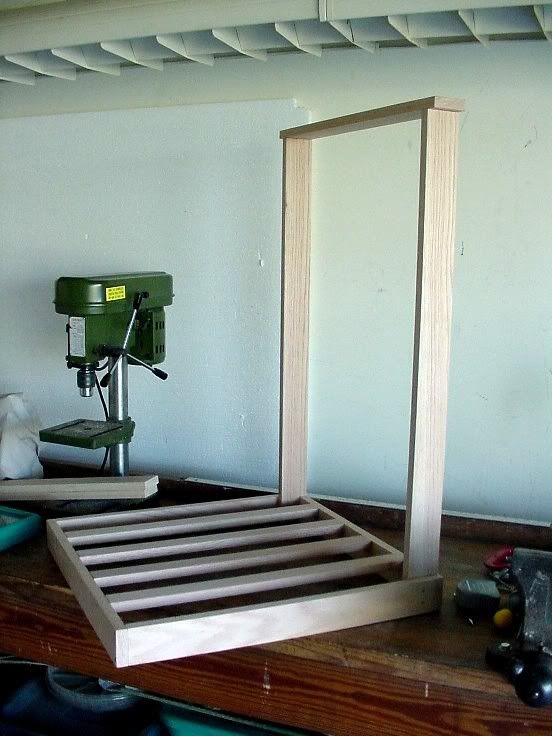

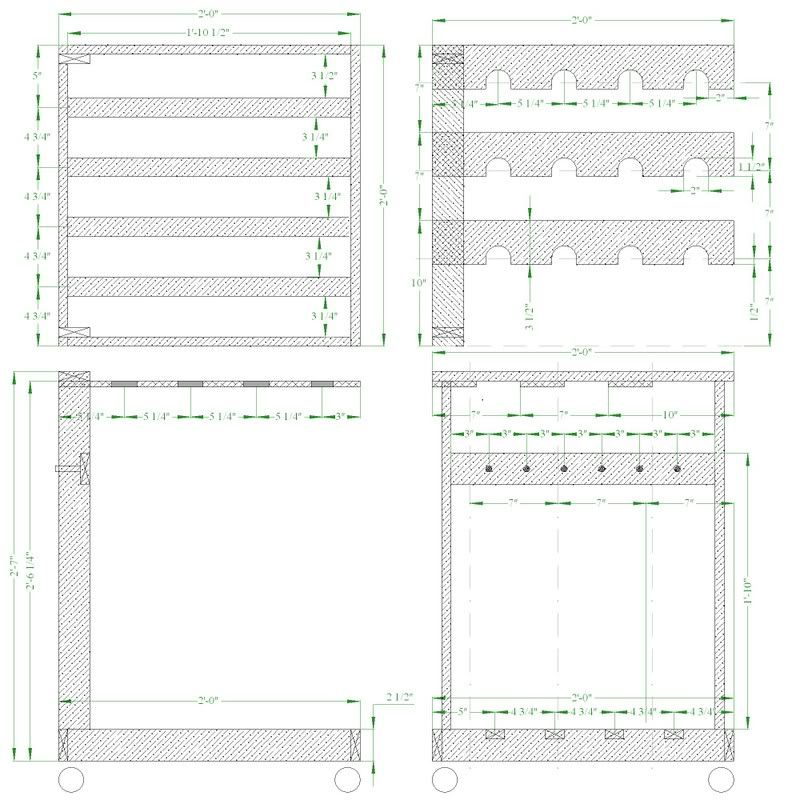

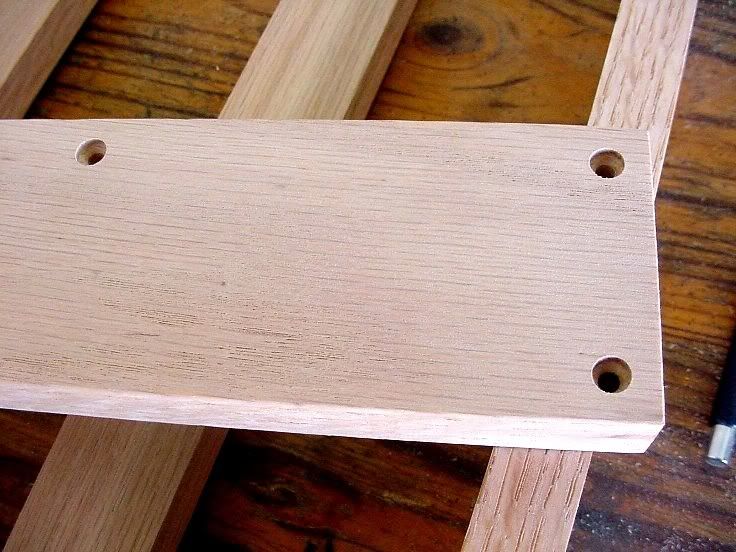

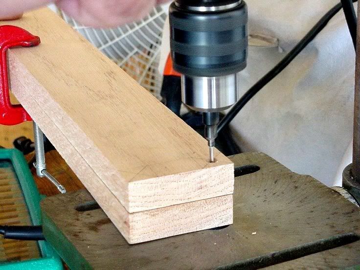

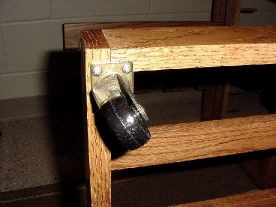

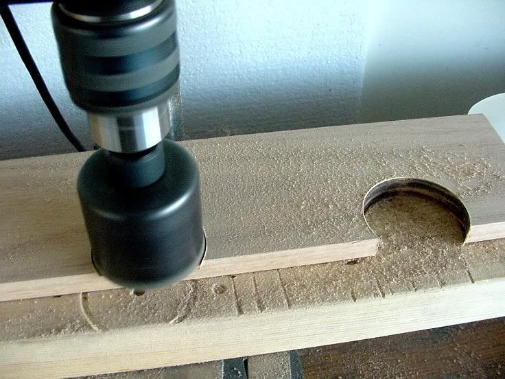

I was asked to post plans of the racks, so here they are. The whole idea was to design them so that they can be made in the simplest way. No biscuit joints, no dovetails, no tang & groove, just straight cits, screw & glue. Material is oak, dimensions are shown below. It takes me 6-7 hrs (depending on the weather) to build a rack, stain it and put two coats of varnish.

Yeah, but that's part of the design. The width & depth are 2'x2' - precisely to fit in a closet!
