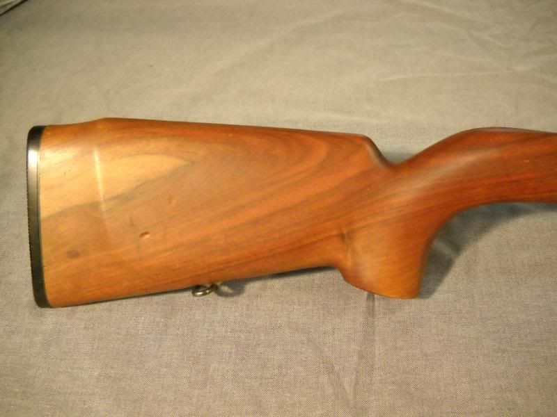

As far as "left hand friendly", my spare CG63 stock has a cheek piece on the right and left side.
