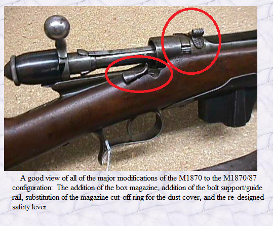

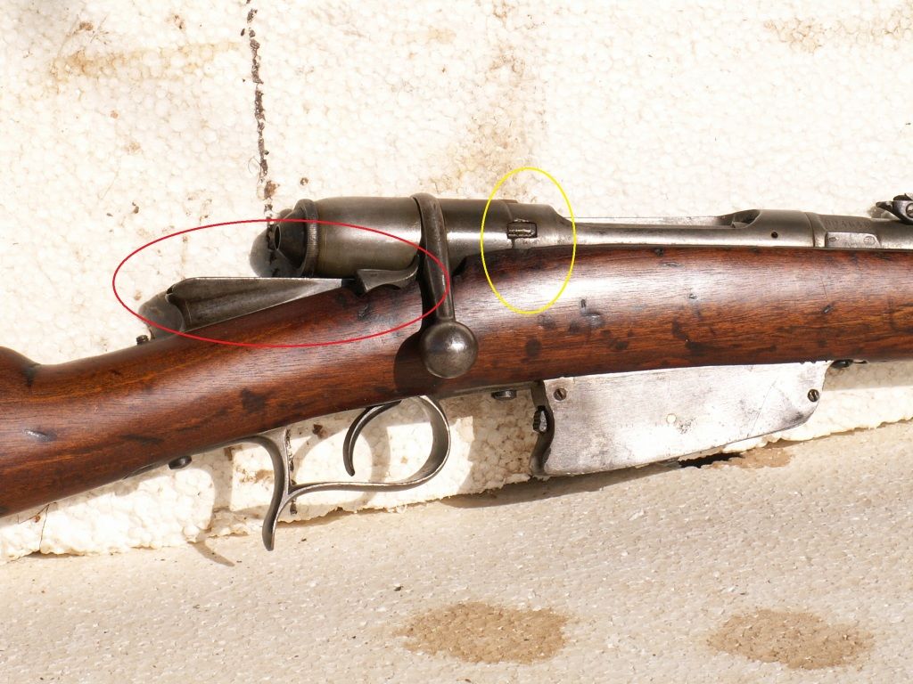

.I am more at home in the Lee Enfield and Swedish Mauser Forums here than the Italian rifle one. However, I attended a Surplus rifle sale, and ended up with this m70/87/15 rifle. The interesting thing is that it does not have the bolt lock / magazine cut-off lever although it has the rest of the 87 modifications. On the left side of the receiver is stamped the number 154. Anybody have any very early m/70/87 modifications that do not have the bolt lock?Also, there is an oval slot milled into the left side of the receiver?.Rifle

.lock/mag cutoff mods

The slot on the left side of the receiver is for a "butterfly - shaped" spring that provides tension to the magazine cutoff/disassembly ring. When the ring was removed from the rifle, so was the flat spring. Good luck finding one. SW
