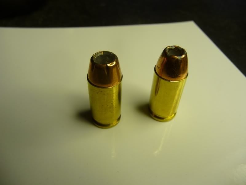

Septembermars posted these photos of the red Ammonet (or 4H?) 20-round boxes.
And here's a photo with the Speer on the right. Sorry about the quality; I meant to re-do this, forgot to, and shot all the ammo up. It's hard to find good help.
