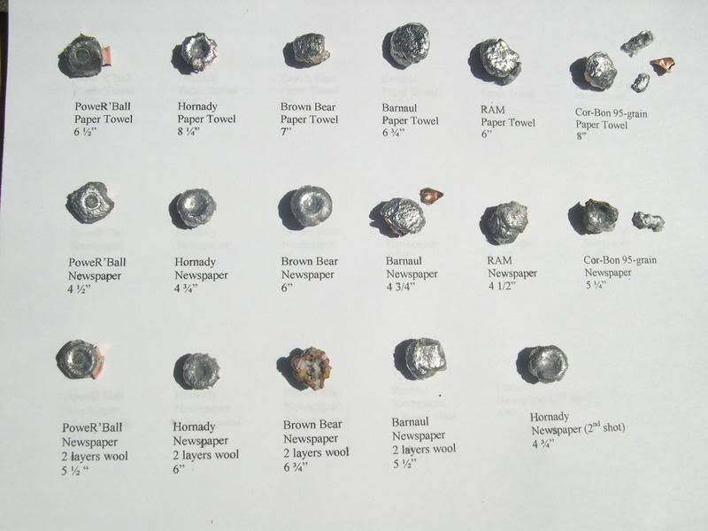

I ventured into hollow point terminal ballistics testing using wetpacks - 2 tests with soaked newspapers and one test with soaked paper towels.
These are backyard tests! I tried hard to at least be consistent, but I don't claim that these results replace laboratory testing. I hope to generate some discussion and I welcome critique on the procedure and results. The effort was fun, informative, and did keep me sober for several days.

First Test
First I took 16 rolls of paper towels apart, tied the pile with string, then soaked them for 18 hours. That made a 12 1/2" high stack. Then I did the same with an 11 1/2" stack of newspaper. All bullets expanded.
Results (Brand, penetration)
(All bullets are Hollow Point):
Paper towels
PowR'Ball 70-grain: 6 1/2"
Hornady 95-grain: 8 1/2"
Brown Bear 115-grain: 7"
Barnaul 95-grain: 6 3/4"
RAM 95-grain: 6"
Cor-Bon 95-grain: 8", fragmented into 4 pieces
Newspaper
PowR'Ball 70-grain: 4 1/2"
Hornady 95-grain: 4 3/4"
Brown Bear 115-grain: 6"
Barnaul 95-grain: 4 3/4", fragmented into 2 pieces
RAM 95-grain: 4 1/2"
Cor-Bon 95-grain: 5 1/4", fragmented into 2 pieces
Newspaper covered by 2 layers of military-issue wool blanket
PowR'Ball 70-grain: 5 1/2"
Hornady 95-grain: 6"
Brown Bear 115-grain: 6 3/4"
Barnaul 95-grain: 5 1/2"
Here's what they looked like according to my old camera:
I shot one round of Sellier & Bellot (FMJ) into the 11 1/2" pile of newspaper and it penetrated the whole stack; coming to rest on a board at the bottom. The bullet just stopped there and showed no deformation.
