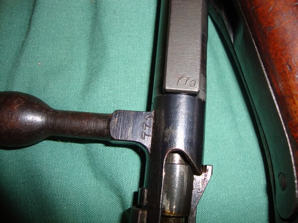

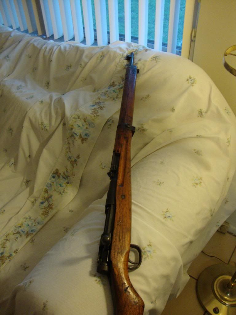

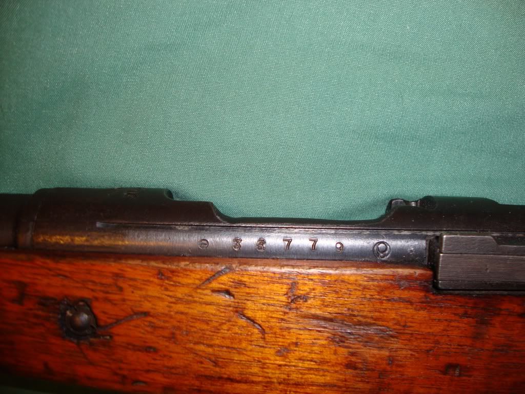

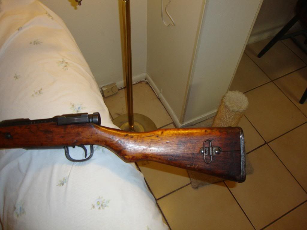

After reading through the thread on someone being taken, I figured I would post my 6th series Nagoya for your feedback. It was sold to me as all matching, which, to my untrained eye, it appears. I paid what I think is a fair price, and it is by no means mint, but as of now I am happy with it. These are the pictures the seller sent me, I have verified the bolt is all matching, even though it is not in the pictures.

Does your bolt have the last three digits of the serial # stamped on the bottom of the handle and on the end of the extractor? On the stem of the safety knob?
445 Posts
The bolt is matching on the handle, extractor, safety and firing pin. There is a picture shown with the extractor and handle. I believe this to be correct, but figured I would see what the experts here thought.
2,742 Posts
Everything but the safety matches on my 6th series. We are at the point of where the manufacturing short cuts began on the type 99 and the bolt was simplified on the 9xxxx rifles. The 90K rifle doesn't even have the slots to screw in the missing AA wings on the rear sight. Not quite as crude as a last ditch variant either...
