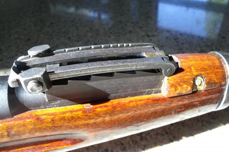

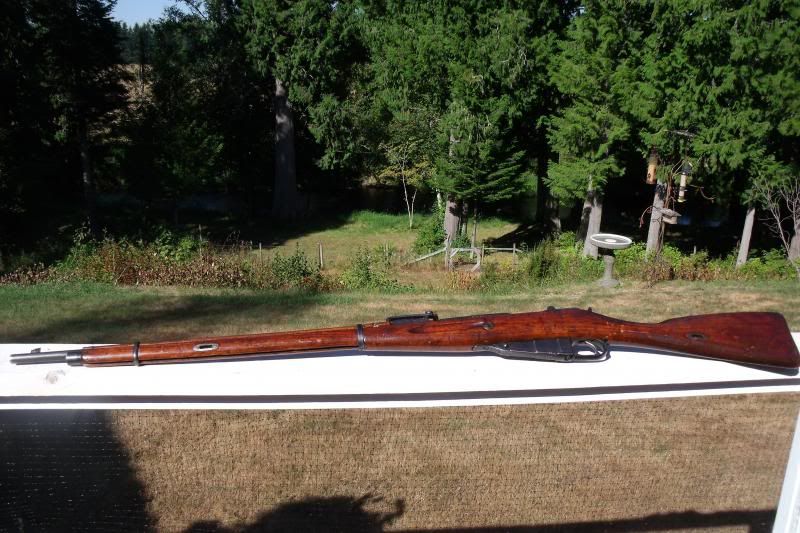

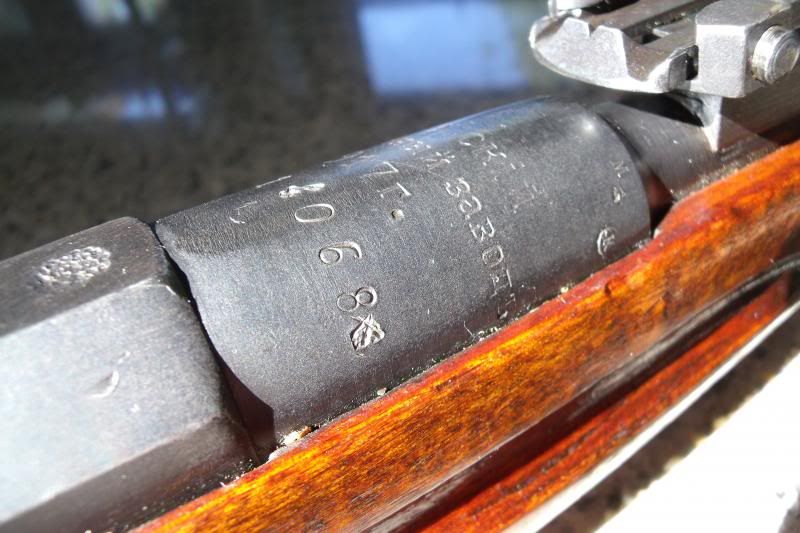

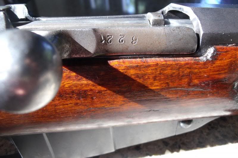

Having a hell of a time uploading pics. Every time I attempt to upload a pic of the whole rifle it fails. Sorry for the jumbled order but hopefully this can answer some of your questions. Also that bore pic is without a single patch through it. It's just full of dust. And I checked under the butt plate for the MI-8 stamps but couldn't find any. Still working on getting a pic of the whole rifle.
Maybe Balkan? I'm not sure. Wire hangers do not look like the SCW type to me.

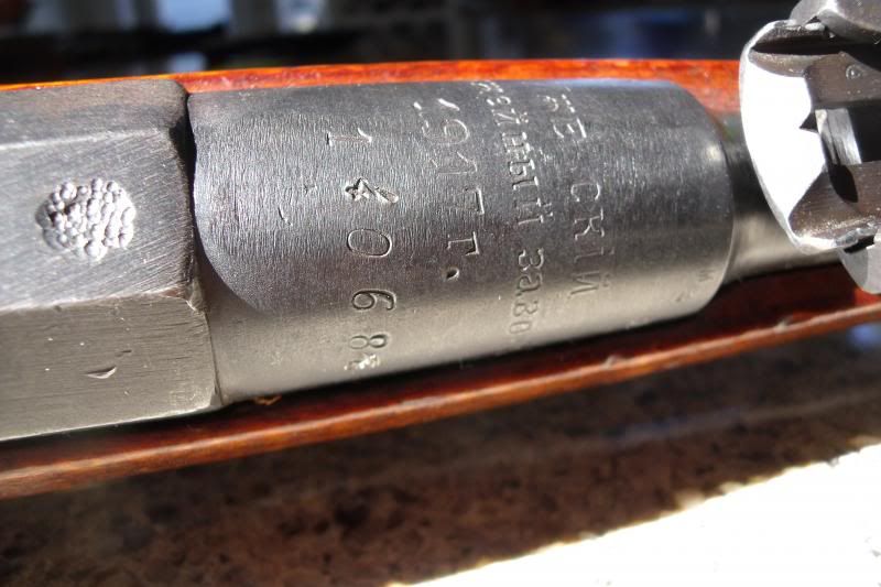

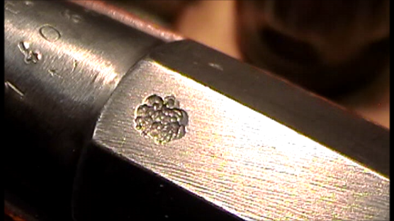

After seeing the pics, it looks like the floor plate and butt plate have been sanded and renumbered. But the fonts of the barrel shank and the floor plate and butt plate do look very similar as well. I wonder if it was a Soviet thing they did at the production of this rifle. Maybe they recycled an old part and restamped it at the production arsenal? If it were SCW, it seems to be "too matching" as with most SCW rifles, no stamped parts usually match. But that's not to say it's still not. Some came out of Spain, and still retained their original parts. The wire hanger looks like it's about the right diameter to be SCW. Do the ends of the wire come together outside the sling slot, or inside the sling slot? It is interesting it is painted black though. Can't tell as the sling is in the way in your pic. Also, does the rear sight have a notch filed out between the first and second graduations? That is a SCW trait, as well as Finn trait. But in this case, with no other Finn identifying marks, I'd have to lean towards SCW. Possible Balkan, but the Soviet crest and Tula arsenal star are still in tact and present. But that's not to say the Finns also didn't remove Imperial/Soviet marks either. Sometimes little machining dimples or a whole top receiver flat was machined to remove the Russian mark. But both SCW and Finn Mosins exhibit this feature much less than Balkan influenced Mosins. Are both barrel bands the solid type?

Nice looking rifle TM. I have the same sling on an SCW, and have seen several other examples of the same. Vic has always stated these are Finnish slings, but some think they are Spanish. The slings could have been an easy addition state side since they work well with the wire hangers. The fore end stock repair and the stock finish look similar to my '27 Finned Dragoon. Could we get a pic of the bolt SN font? Denny

Usually it's a half notch between the first and second graduation. The highest part of the first graduation is usually filed down. A side view could better determine that. But it looks like we could rule out Balkan, as there is usually a piece of metal wedged in the rear sight area and is peened in place. This one does not have that, or remnants of that.

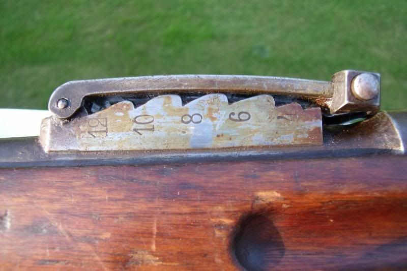

Here is what a SCW rear sight notched would look like. This from a 1916 PTG M91

Whoops I thought I had uploaded a pic of the bolt. It's a somewhat early Izhevsk bolt that I think is the way it left the factory. It doesn't appear to have been scrubbed and it has all the correct Izhevsk proof marks.

Barrel shank severely defaced.
The bolt on this one also looks to be non scrubbed. Interesting similarity to yours. But it's not all defaced.
